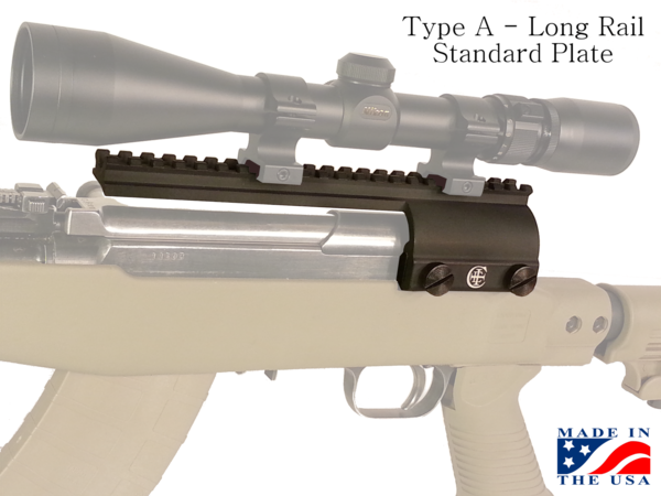

Hi guys,
Do you know anybody who can manufacture something like a combo of extended choate scope mount rail or similar and a front piece from a KWIK rail, which will attach via rear sight screw/pin ...
you may even combine the Magwedge gen 2.0 rail (except it has to be elevated to allow cleaning of the bolt), the front/ middle piece of it (which allows stripper clips) AND choate rail style in the rear.
Such rail will have two advantages:
1. will hold zero forever as the rear piece will be tapped. no matter what you tell me about magwedge/ kwik rail,,, sooner or later it wont hold zero 'coz that pin in the rear will become loose
2. it will be elevated like choate mount, which will make cleaning an easy task, w/o any mounts to be removed.. again, choate mount is nice coz it allows you bolt cleaning w/o removal of the rail
forget me my crazy drawing, something like this:
I don't care about anti-drill and tape ppl
rail maybe removable just like below, but has a long length and the front piece has to be stabilized to the former rear sight pin/ screw
I have never understood how you think that pin at the back comes loose, as its tagged straight into the receiver
now there may be some very slight movement because of the hole dimension being slightly over sized, but all this would do is slightly open up your groups, and not cause a loss of zero

1. my friend had your rail and after 10 cleanings the screw became a bit loose and the thread for the allan key was almost gone...with mechanical friction anything will become loose.. sure some ppl take 10 cleanings, some 1000.. but it will happen.. it is inevitable physics of living on this PLANET: if you take pin/ screw out to clean repetitively it will become loose eventually.. it is suboptimal compared to red lock tight forever screw-no argue about that... unless we are not talking EARTH
2. Besides, I don't like the idea of moving my scope up/ down every time I have to clean the rifle
3. Again, minimal effort-minimal results, non-removable screws will be never comparable to removable screws/pins, big time. I don't mind basic drill+tap. Some ppl like to keep the rifle as original as possible and those ppl mind anything you do to the rifle, if you install something, even it is reversible, you are not a collector type guy, you may sacrifice 270$ and all you are looking is drop and play thing without any drilling... if those ppl were more or less proficient with basic skills, they would drill... otherwise.. they are looking for an easy way of rifle mod, those ppl don't shoot a lot and they are your market. If you go through 1000 rounds per month removing the rear pin/ screw becomes not only annoying, but crazy and potentially affects optics... this is mechanics-see above
I don't see a problem with changing out worn out parts such as screws.
Obviously I cannot speak to your friends experience but if a screw wears out extremely quickly it is either defective or perhaps there is some operator error.
Either way he is welcome to contact me for a replacement.
I see nothing wrong with replacing a worn screw either, no different than having to clean the rifle , just basic maintenance .

My personal experience with those style of mounts is the same as OP. Yes the pin fits tight in the receiver. BUT the mount doesn't fit tight around the pin lol. The moment the bolts come loose at the back, the rail in most cases has about 1/16" of up and down play. If u keep the bolts tight, I noticed after considerable use, the mounts aluminum gets slowly chewed away buy the bolt heads.
Yes, there is no an ideal mount.
Again, the more you disturb something, the more moving parts and especially repetitively moving parts, the worse it is.
If you don't use corrosive ammo and use scope on SKS... then sure the magwedge rail should be just fine... if you use SKS the way it was designed-tactical storm/ CQC / battle rifle and you design it to be used with any ammo/ SHTF, then magwedge rail is suboptimal BIG TIME
As nobody is willing to manufacture the one I want, I guess, I will go for choate (rear sight + red dot) + scout (front sight), cut the barrel to 18.5" or cut the barrel and restore the front sight and no need to choate and back-up sights to be elevated to picatinny's

That's because the best mounts are already made.... The choate drill tap mount, the promag drill tap mount, or the Russian molot style to attach a side rail or optic.
If u want stripper clip usage.... Mount the mount back further to allow room. But don't expect to use a scope.
If u want to use a scope without stripper clip usage, mount the mount more forward. If u what the option for both, get the Russian side mount.
