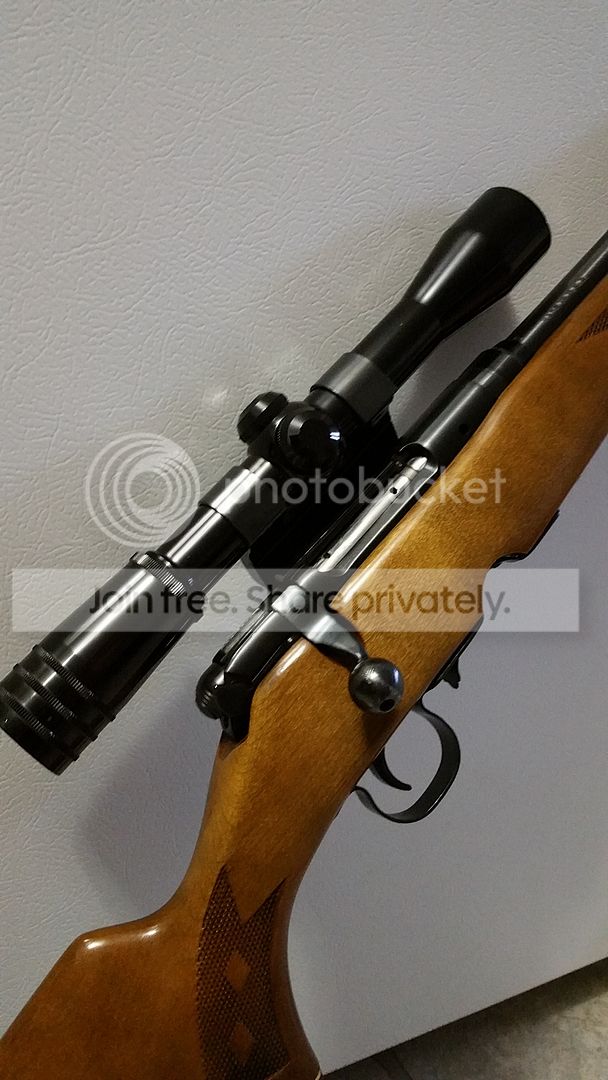

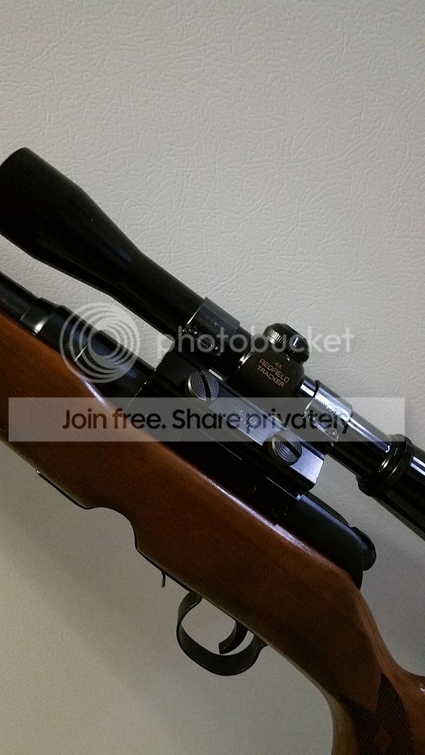

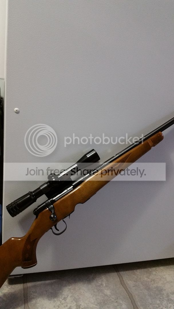

Here is my model 830. Minus the band. Not sure what ever happened to it as Dad got it used. There is also a couple holes in the buttstock on the side. I assume this is where a sling loop was attached....
Your 830 looks identical to mine. Only thing that band was designed, along with perfect fitting to the wood, for accurate shooting, by taking the vibrations out of the barrel on firing.
