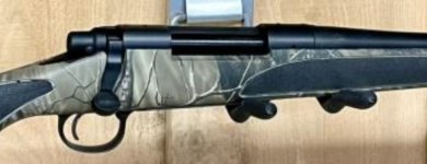

I just worked on one for a buddy, says XCR and Stainless on the barrel, some kind of black coating in the metal, ain't sure.
Happened to take a pic of it by chance.

Thanks, the finish matches what I'm looking at.

Ironically, the reason buddy brought it over to me to work on, was the ejector was froze up with rust, would extract fine, but zero ejection.
Everything stainless except those little springs and plungers, nothing too far gone at least, good soak in balistol, working the plunger, blowing it all out with compressed air through the process, right back to functioning.
