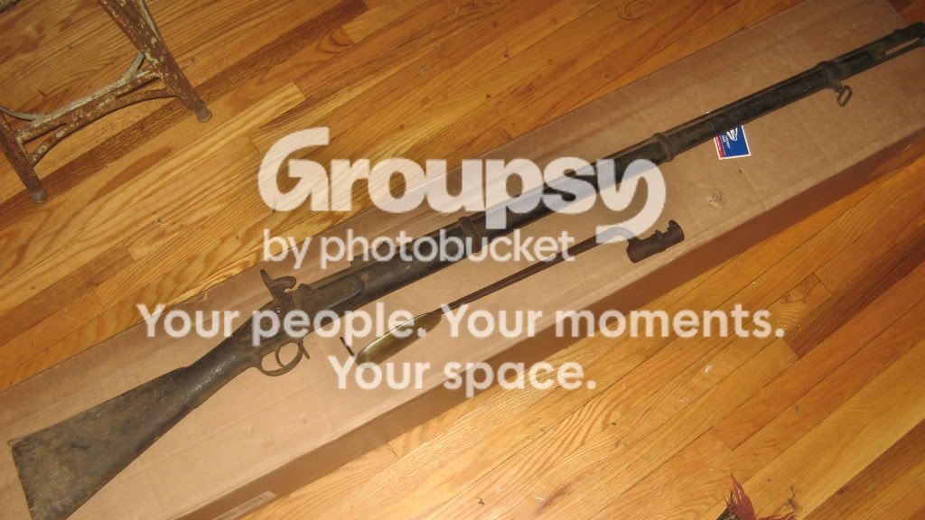

A few weeks ago I purchased one of the Nepal cache 1853 enfield pattern rifle muskets from IMA in -as found condition-
I figured I would share my thoughts and progress so far with you guys.

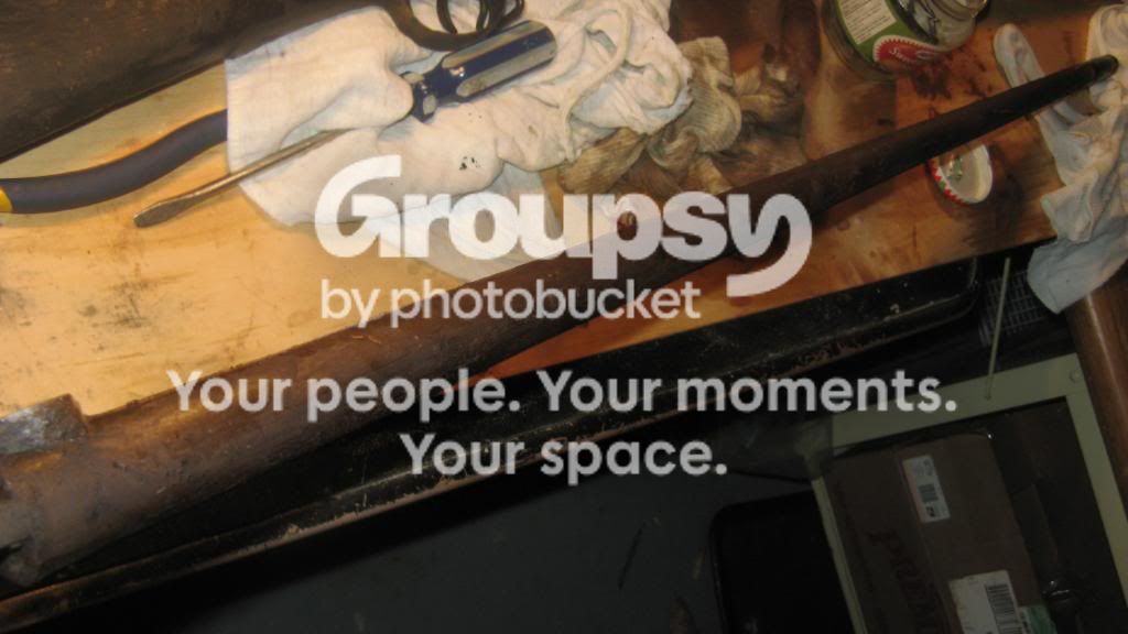

She arrived covered in a solid peanut shell like black layer, looking mostly complete
I have so far stripped her down "yes carefully" and started cleaning her up and inspecting for damage

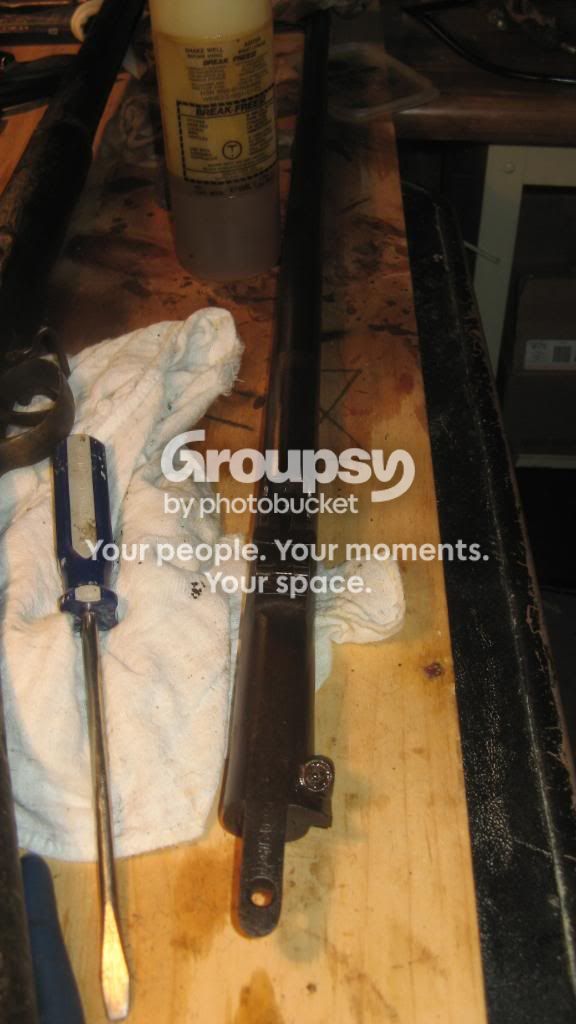

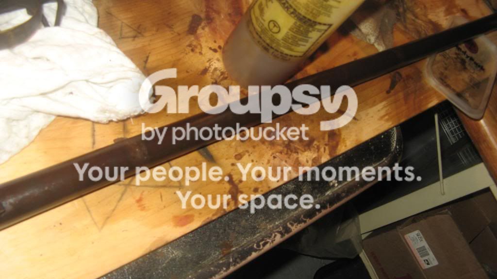

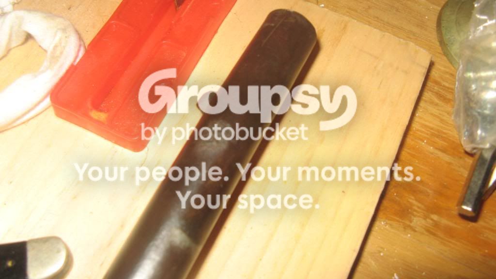

Here's the worst of the pitting on the barrel "my example is dare I say in splendid shape!!"
The bore is beautiful with a couple pits but tons of rifling and shine!!!
All that color is original finish....just sublime!!!

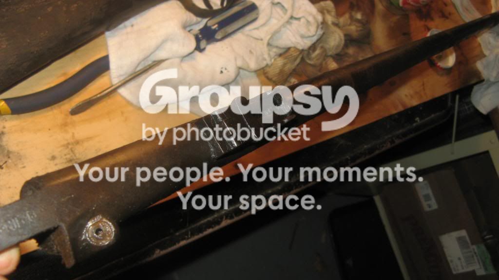

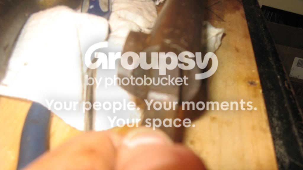

Worst bit is the nipple needs to be filed out.....but I'm not to that point quite yet....

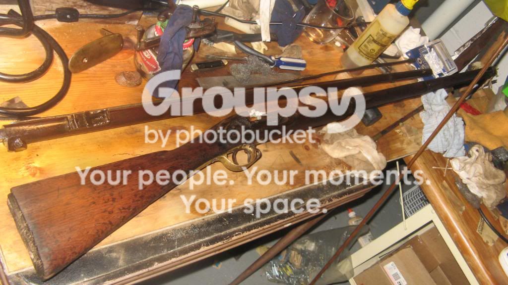

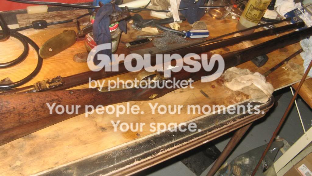

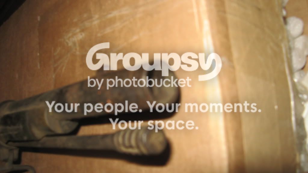

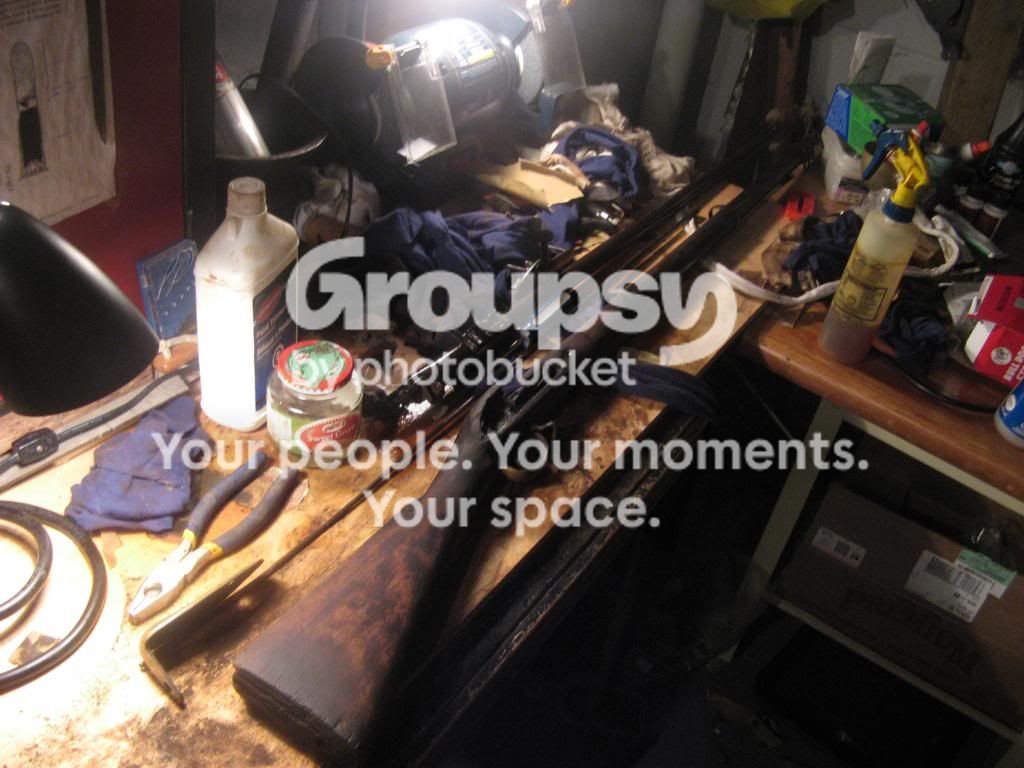

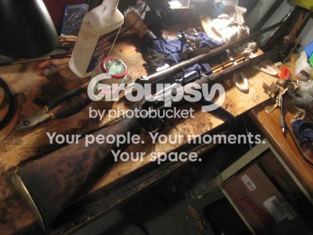

And here's the stock cleaning progression so far....yes lots of time steel wool and mineral spirits....sure there's easier/quicker ways
with caustic death chemicals that will eat the wood as quickly as the grime.....
I am convinced this is the best way to maintain the integrity and beauty of the wood, which by the way is coming up beautifully.
So yes here she is so far coming along far far better then I ever could have hoped!

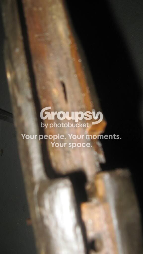

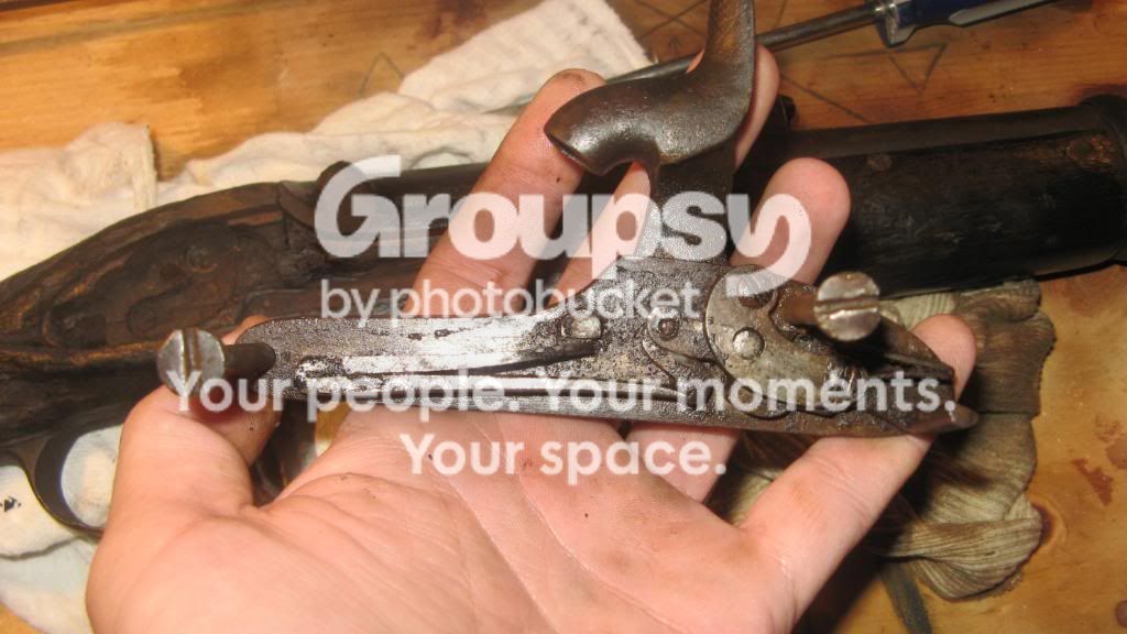

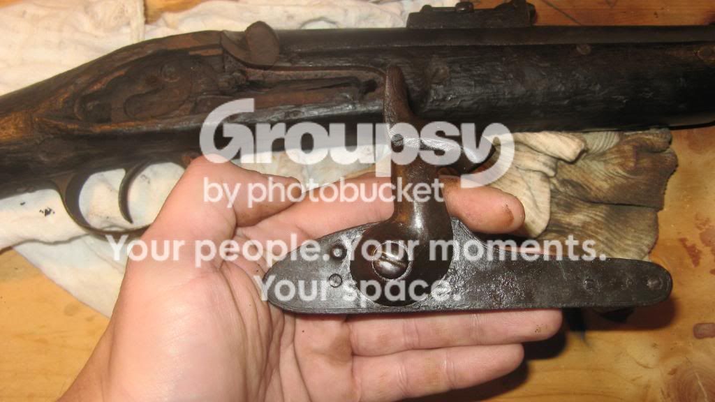

The lock has some odd french looking marks to add to the whole mystery of it.

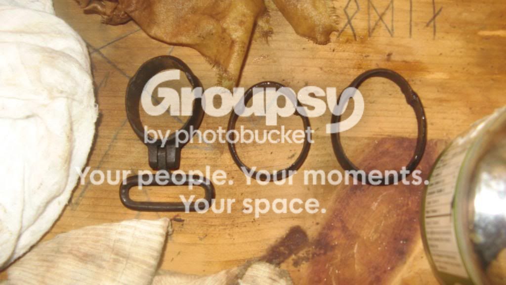

The bayonet fits like a glove and the ram rod is in good shape too.

I take it the nipple is broken off in the hole?
Somewhere I have a set of left hand drill bits...you drill progressively bigger until...hopefully one of the bits grab and it suddenly spins the stub out.
Lots of penetrating oil etc...
I haven't even really gone gung ho on the bore yet....:eek:
In between scrubbing and stripping and staring at everything else I give the bore a bit of the clp and a few swipes with the bore brush "a worn out 12 g one:D"
Then clean the "scrubbins" out with a rag on my rod jig and there you go.
Lots of rifling, what may be a few scattered pits and lots of shine, needless to say I'm happy with it so far.
The clp just left in there seems to slowly dissolve the gunk.
With the nipple "top broke off leaving the body in the threading" I'm going to file a slot in it that will fit a screwdriver and screw it out with some light heat, If that doesn't work Ill let the gunsmith do it and pay him 50 bucks for his time.

I just finished putting a few more hours into the stock, there's just so much grime - STILL- coming off of it....wow...
Anyhow shes really coming a few more hours of scrubbing should make the stock ready for me to begin some repairs.
A few cracks need to be filled/epoxied and a small part on the toe needs to be replaced....Then I will fix any small cracks in the breach and bed it.
The pictures here are after further degreasing/scrubbing with mineral spirits,
After that I give it all a good soaking with more mineral spirits and just let more of the crud be drawn out as it dries.
Very fun project
No rot, just tons of goop and soaked in mystery sludge in all the nooks, tiny cracks and crannies.
The mineral spirits is drawing it out a bit at a time, to repair it in a lasting and quality fashion all the sludge must be gone, thats taking some patient work.
