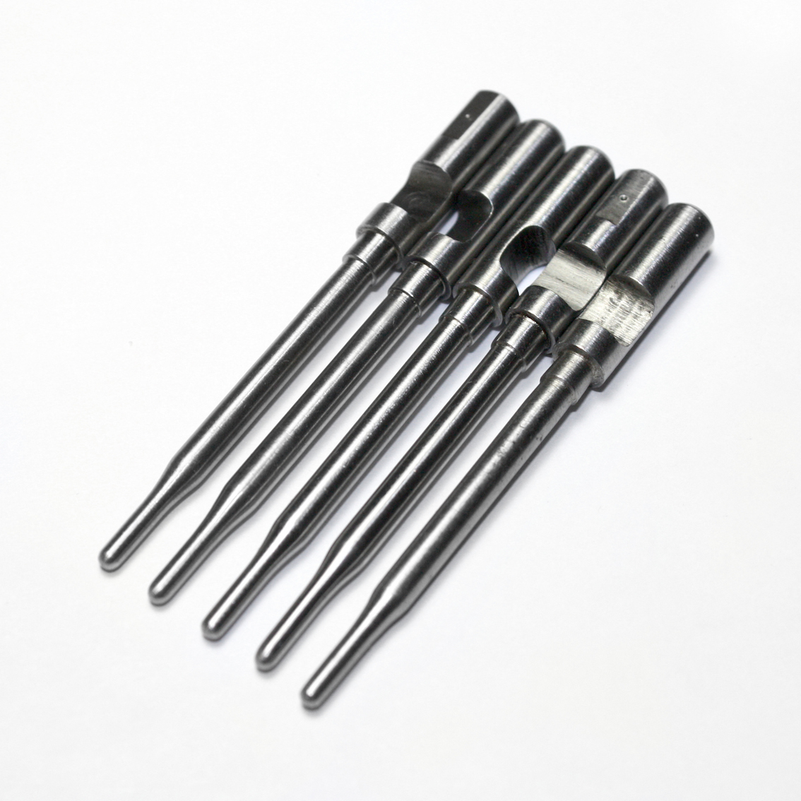

I am in need of another TT-33 Firing Pin. These damn guns seem to blow their firing pins on a regular basis. This time it lasted 400rds before it broke. Last time was right around the 400rd mark as well. I am in search of another TT-33 Firing pin to get this gun in working order and then for sale it goes. Anyone know who's got them instock?
What do your fired cases look like? There was a great post a while back about the pin "dragging/wiping" across the primer and therefore putting added stress to the pin. Pretty sure there was an update on the hammer for this.
I reload for mine, and they're more like a 9mm than the snappy original round.
Much less firing pin wipe than before.
Will be nice to see a picture of where it did broke ? and as other asked already, what kind of primers was hitting when happened, also was it oiled recently ?
kinda hard to imagine what would break that solid piece of metal :)
