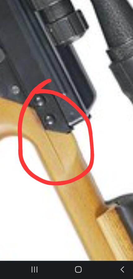

I was looking at the picture in the original post of this thread. Anyone else see this? I didn't go through the entire thread to see if this was pointed out. Cracked??
