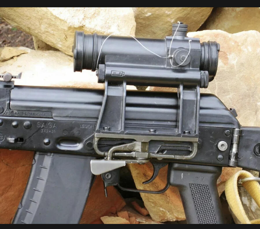

051BA13E-AC3B-4D24-A020-5293B4CF16C9.jpgAnyone know if side-mount Belomo red dot and POSP can be mounted on the side plate directly? (e.g. without picatinny rail), IMO it looks more authentic with direct mount Belomo red dot/POSP..
Unfortunately, TI's rail DOES NOT have a central recess/channel to allow positive locking of many sidemounts, including the one you've shown. The rail could be modified, or you could remove the keyed-cylinder-thingy (the bit with a bend in the middle) on the locking mechanism itself to allow it to fit on the rail. I got an NPZ Universal AK mount and its got the exact same locking mechanism.
