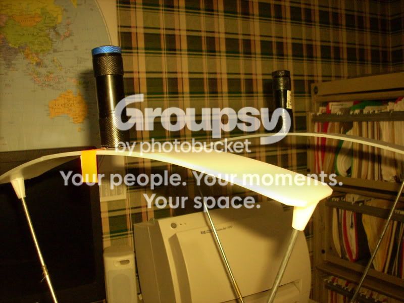

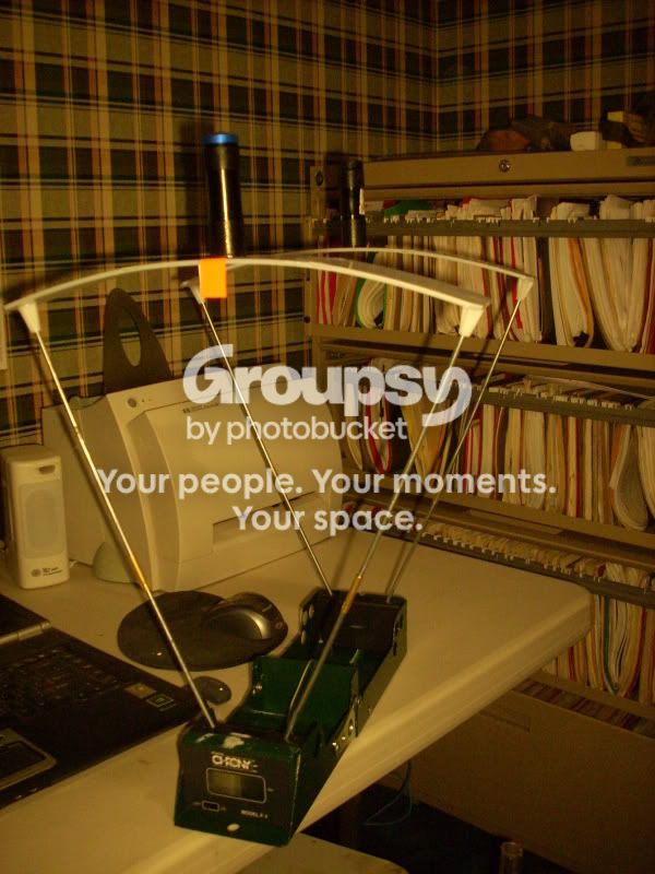

A fellow brought his brand new Chrony to the inoor pistol range yesterday. He had a pair of those little multi LED flashlites (the $3.00 ones) to supply overhead light.
He just balanced a light on top of each diffuser, directly over the skyscreen. I was skeptical, but it worked like a charm.
I bought a Chrony for indoor work and used some Super Glue to hold the flashlights in place.
Here is what it looks like. The red tap is an aiming mark. I aim about 2" below the tab.

It looked to me that you extended the rods holding up the diffuser. I assume its to make more room for the bullet to pass through so you don't hit the rods and bust up the chrony.
Instead of using those rods I use plastic straws from the dollar store. If you hit one it has zero effect on the chrony itself, just replace the straw. I have seen pictures of chrony's theat have had a bullet hit the rod and really messed up the rod pockets.
Update: Sometimes I got an error message when turning on the lights. Chrony siad that is becasue light is too bright. This was fixed by taping a piece of white paper underneath the plastic difuser. It was taped so that the paper is curved on the bottom to get it moved away from the plastic by a quarter inch or so. This reduces the lght, gives a bigger 'sweet spot" and makes the error message go away.
