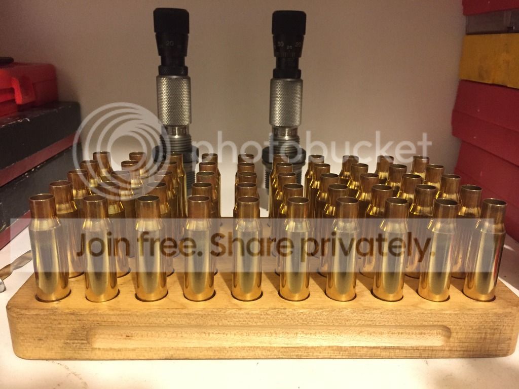

Below I have posted a picture of my Lapua brass that has been fired 18 times. It is now prepped and ready to be loaded for the 19th time.These cases have not been cleaned after annealing. They were cleaned in stainless steel pins prior to annealing
I would like to see how you can get any cleaner than this with an induction annealer.
