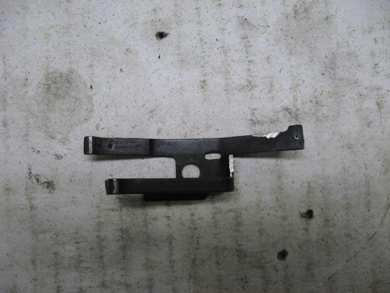

Please correct me if I use some improper terminology, but from what I can figure out:
When the safety is engaged (i.e. perpendicular to the barrel) the rear trigger unit tab is forced downward (against spring pressure) past the base of the lower half of the “L” shaped sear, by the shape of the safety. In this condition any pull of the trigger will not release the cocked striker as the trigger has been disconnected from the sear.
(something like this photo, except the rifle would be cocked and the striker on the sear)
However when the safety selector is turned to fire (parallel to the barrel), this now allows the trigger unit spring to push the rear trigger unit tab up and catch the base of the “L” shaped sear. In this case the trigger and sear unit are now connected and a pull of the trigger will allow a cocked rifle to fire.
In the case of my (I’m told) unfired rifle, it will not fire because the small tab connected to the trigger unit won’t catch the base of the “L” shaped sear in either position, leaving the trigger disconnected from the sear.
So, sound familiar? I stared at it all night last night trying to figure out what to do next but I’m unsure. I’ll probably take out the pins and pull things apart, then reassemble to see if that helps, but I can’t see anything binding, blocking etc.
Any other suggestions? Is this a common problem?
(Thanks to Curtton for the use of his photos)
