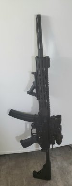

I like it the way it is ... added flip up battle sights, co witnessed to a Vector Frenzy circle red dot + Primary Arms 3x magnifier ... runs good, yes the trigger is a tad heavy but I dont mind it, changing springs is not difficult. The price point is good - it runs good, mags drop easy etc., everything is a good fit - ergonomics ✔ Its worth the price. Tried several different 115s + 147s and it ate all, accuracy same as Mark's reporting ... nothing for me not to like 👍

I think the lightened barrel really helps with the weight and weight balance. Makes it much easier to move around.
