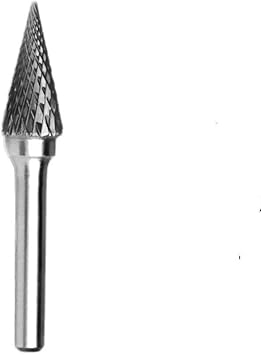

My favorite for inside the neck is a 1/4 inch shank carbide burr, but I have never found anything very good for the outside of the necks, although I do have a unique design concept that I might produce some day.
