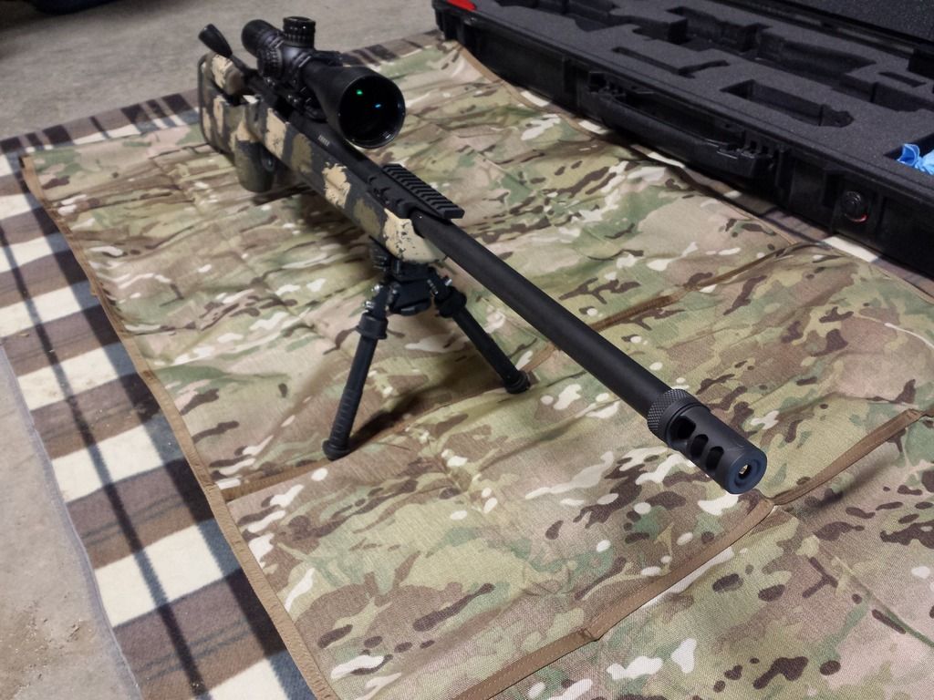

This is how it looks on a Rem Sendero contour:.
