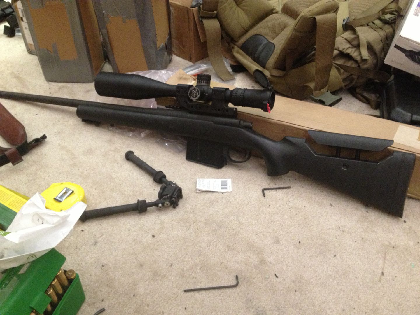

Installing the Loggerhead ACP adjustable cheek riser hardware on my .338LM
Nice work Kevin, looking good. Don't worry to much about using the Devcon, you will have at least an hour before it starts to harden and the stuff is like peanut butter so it doesn't run everywhere like other epoxy's. Just mask it off good where you don't want epoxy and your good to go!

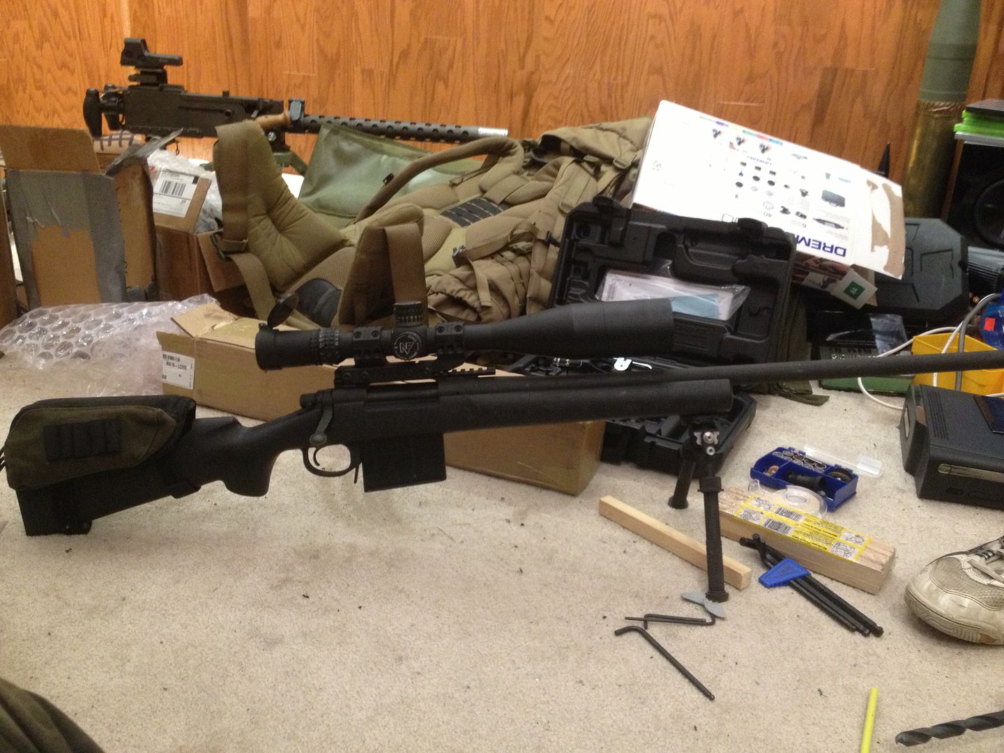

I threw the rifle together to see if fit would be comfortable... my goodness it feels like a totally new rifle by getting the cheek weld perfected. When I lie down behind the rifle, it just... fits. The scope comes right into place exactly where it should be and does not take any moving around to bring it into perfect focus.
Most of all, my main goal was to keep the cheek bag, and it works perfectly on my rifle. I did not do this modification for looks, (although it is nice to do it right) but for practicality and proper fit of the rifle, and anybody who uses their rifle a lot and records dope can not deny that a cheek bag is pretty damn convenient for guys who go out in the bush to shoot.
I am happy. :D

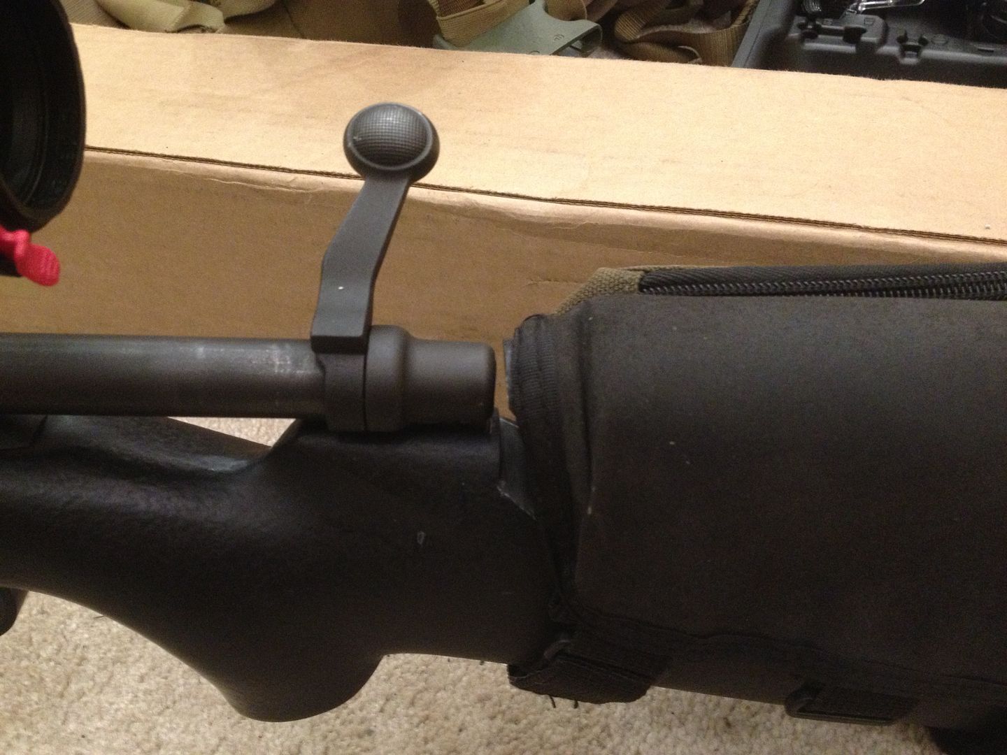

Bolt at full rear position.

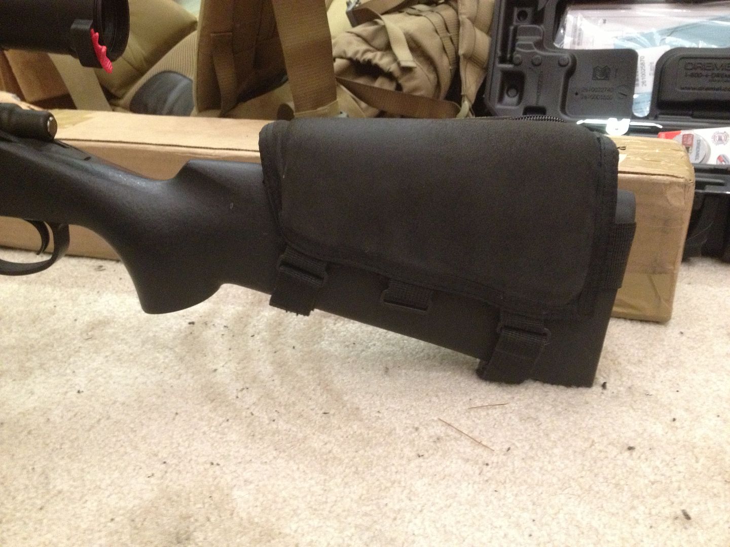

I'm sure you have, but try without the stock pack. I find them horrible for positioning. I have one, and maybe it's my face, but I want to get rid of it quickly.

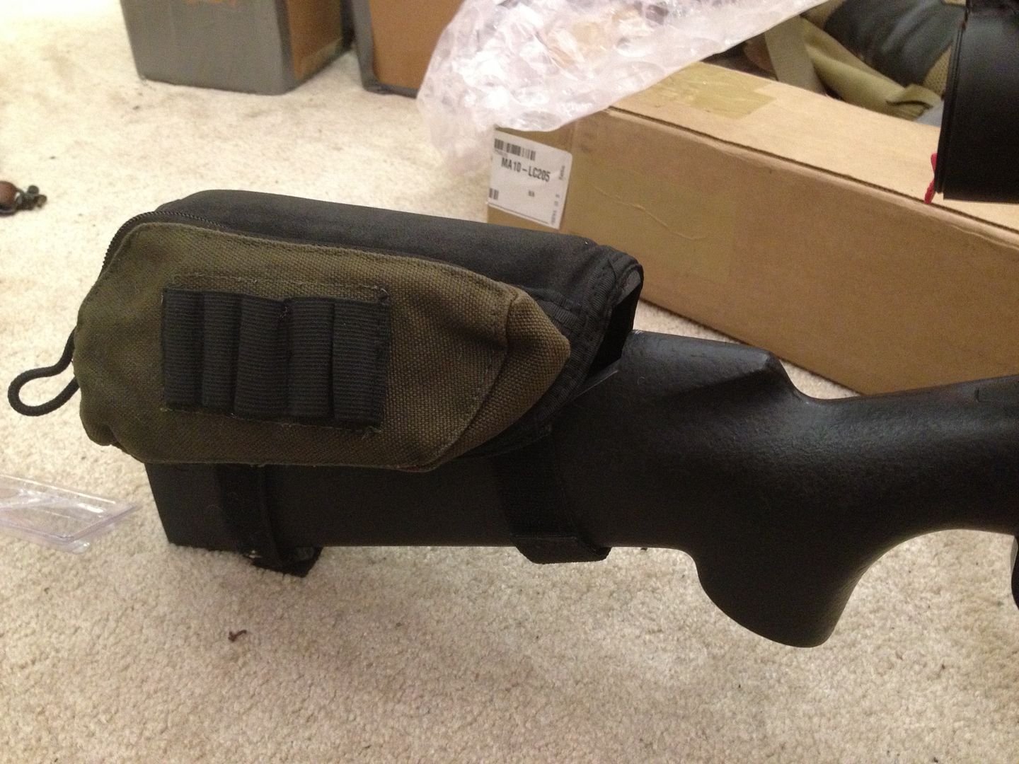

Had a bit of free time today, so I did some more work.

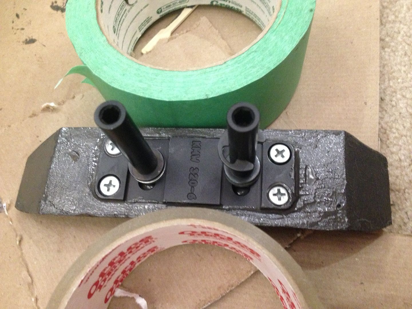

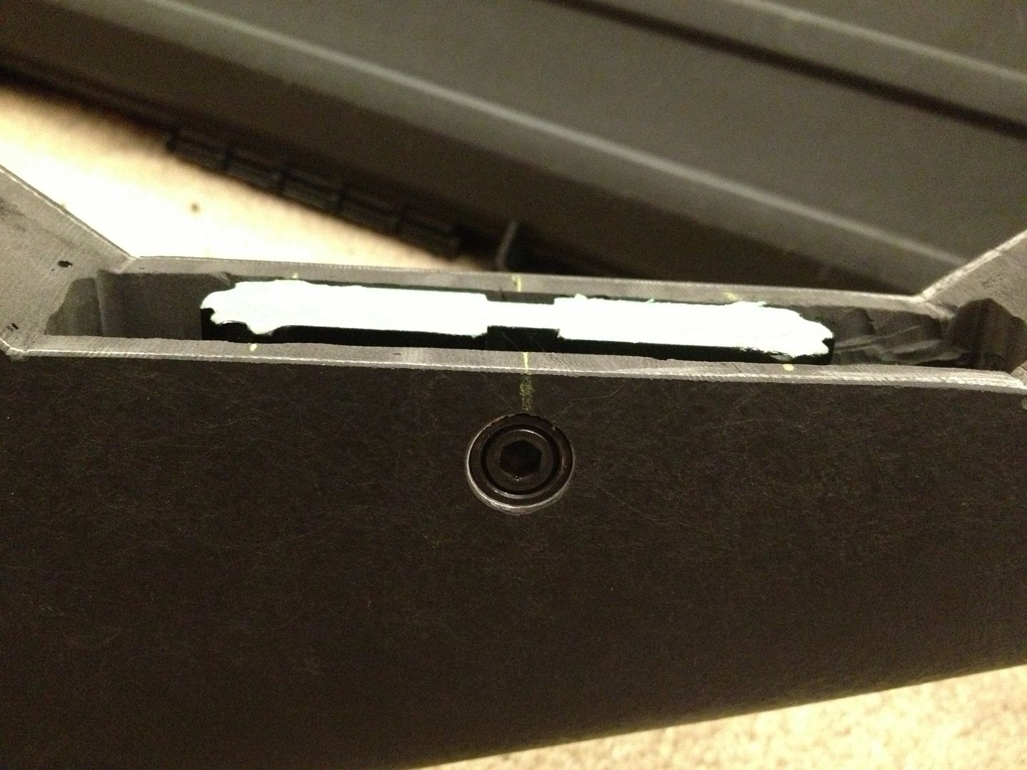

Followed the instructions to a tee, and the putty process went fairly smoothly all in all.
The stuff has roughly the consistency of peanut butter, so it is workable, but tends to cling to whatever tool you use, so some patience is required to do a reasonably clean job.

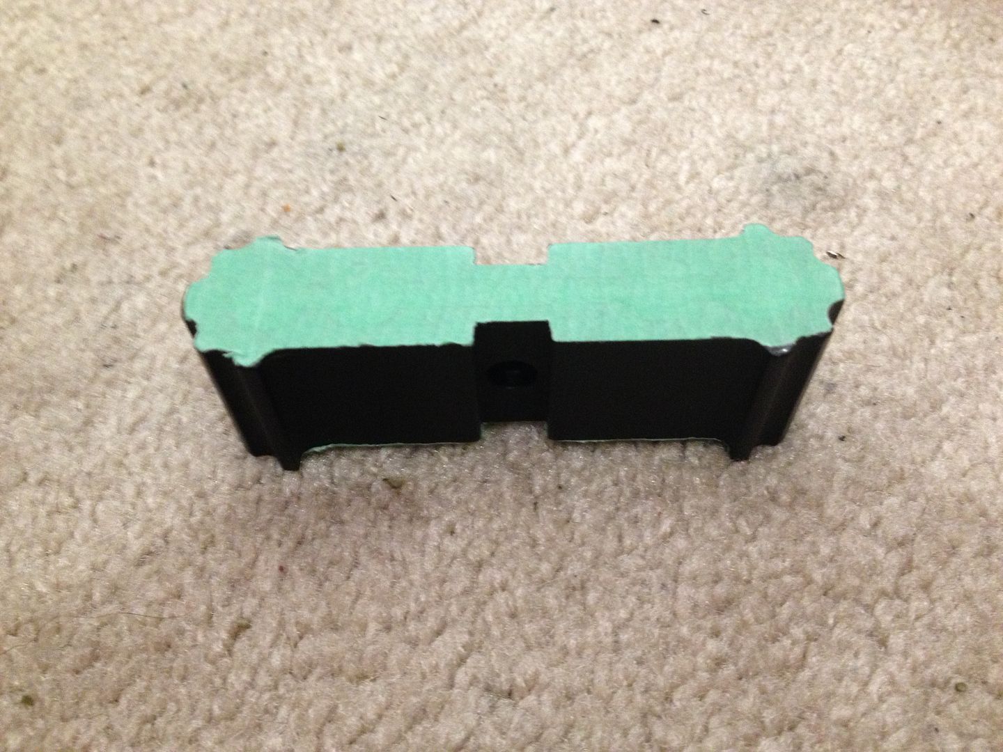

I started off by taping off the top and bottom holes on the loggerhead hardware so no epoxy got into the inside of the holes.
Quadruple checking the test fit...

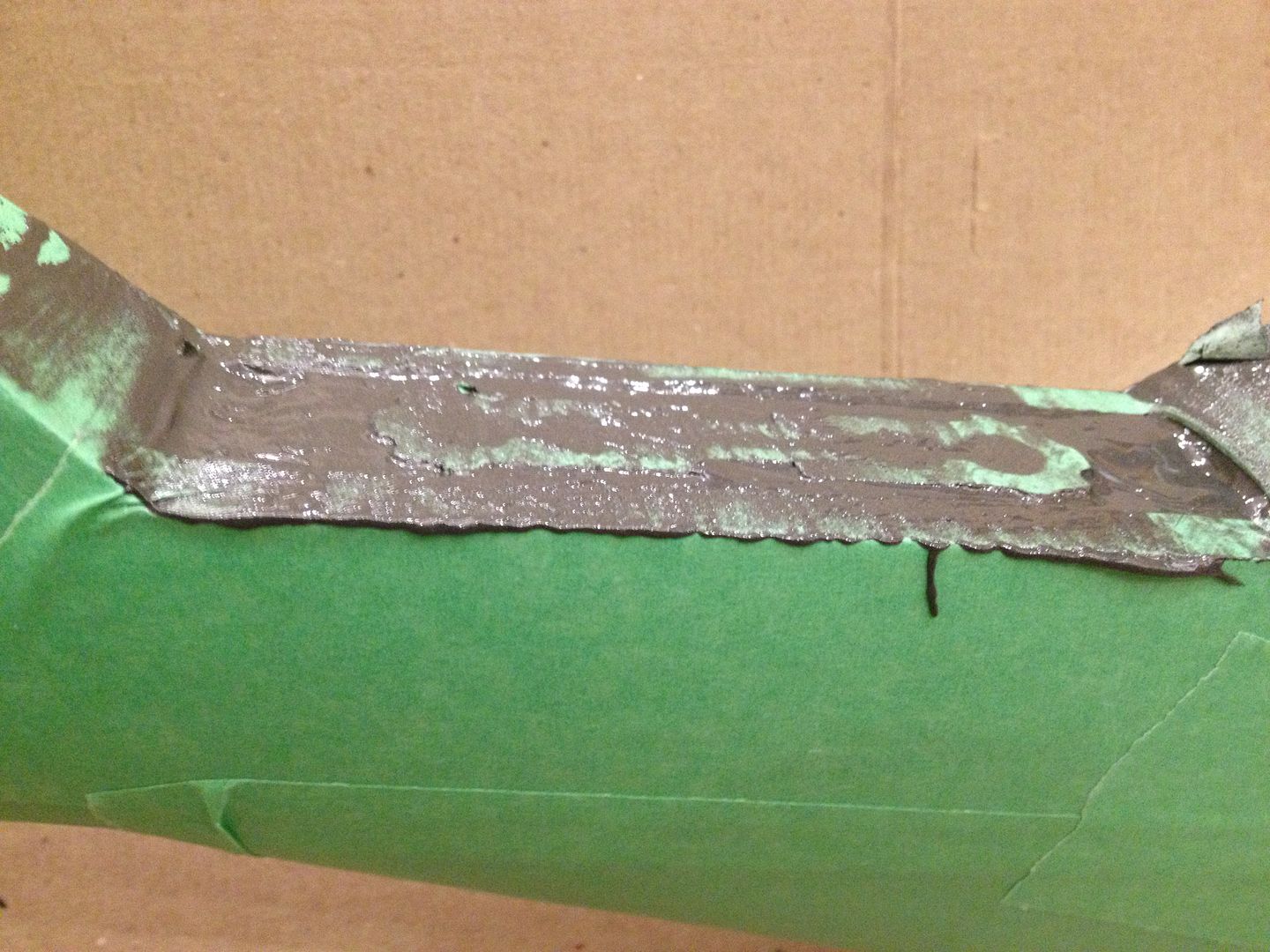

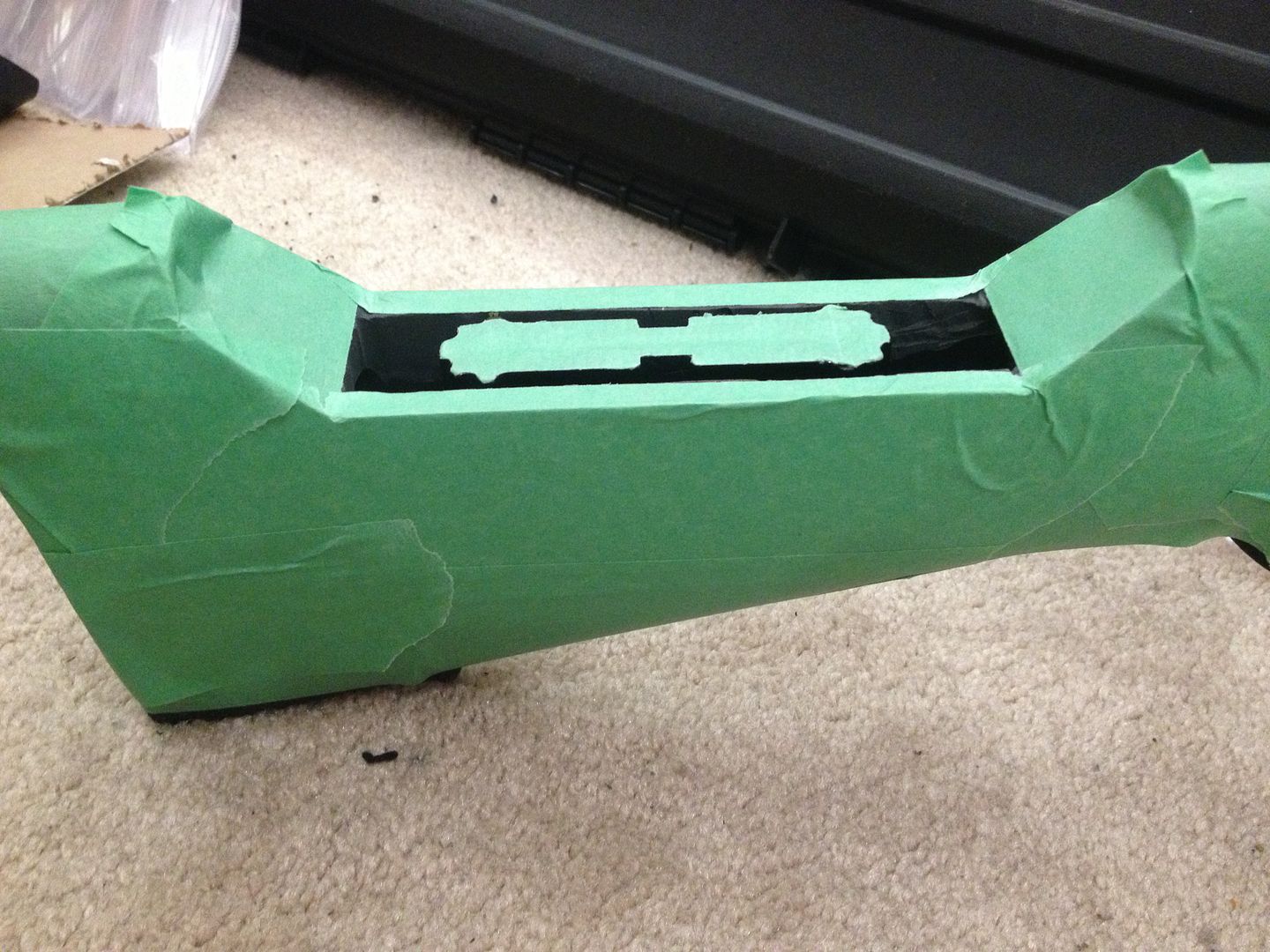

All good. Now taping up the rest of the buttstock, as I had no clue how messy the stuff would be.
And after about 35 minutes of working with the putty, she was secured on all sides! Maybe not as perfectly smooth as others could have gotten the epoxy, but this was my first go at it, and I am pretty happy with the results. I can smooth it a bit more after it cures as well if I decide to. Thank goodness for the tape!
Since I did not trust the provided screws alone to hold the upper assembly, since it is a foam core stock, I used a bit more the Devcon 10110 and epoxyed and screwed the upper assembly to the upper cheek piece, squeezing it into the epoxy. I used the last bit of excess 10110 to coat a thin layer of the exposed foam and fibres as well. I will use something else for the bottom of the stock as well, just to make sure the foam and kevlar fibres are protected properly.

That thick layer of epoxy will shrink a fair bit on curing, leaving depressions, as you will by now have noticed.
Maybe knock off the high spots and give it a second glaze coat for finished appearances?.

And finished with the bag. She sits bloody perfect on my cheek, such a relief to have the correct chin weld now.
Some fine and comfortable shooting will be happening this winter for sure!

I'm sure you have, but try without the stock pack. I want to get rid of it quickly.
I'm with Shibby!.
It's not polite to offer a try, with all that frozen nose mung 'n drooley crusties all stuck into the nylon.
^ that said ^, & despite the onerous potential health issues ... :HFU:
