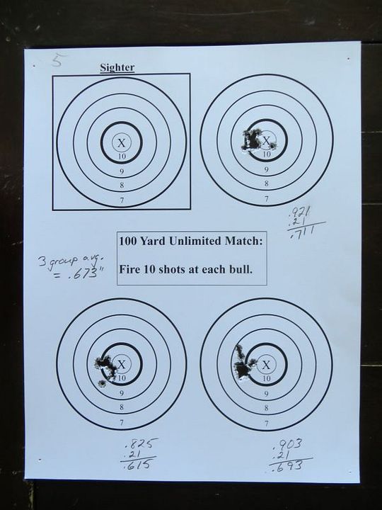

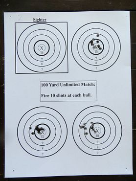

I was able to continue testing ammo at 100 this morning. I tested two lots of Midas + for the first time and they produced targets with sub-1" averages. That's what I've been looking for.
Below, the average for each target with this lot was under 1".

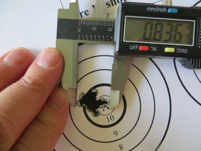

One of the groups on the first target was very nice to see. It measures 0.836" outside edge-to-outside edge, for .626" center-to-center, the smallest for this season to this point.
The other lot of M+ didn't do as well this morning, but it must be tested again. The bottom right group on the last target below measured .700" center-to-center.
Compared to the two lots of M+ I tested yesterday (see above, post #38), these two lots of M+ are better. The different performance illustrates that lot selection matters.

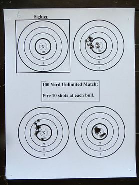

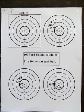

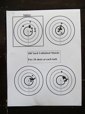

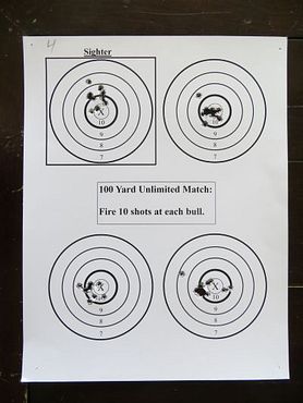

Grauhanen: A quick look at your Midas+ targets in post #38 shows, to my eye, most groups had a consistent vertical problem (except for that one best group). I am guessing that is why you mentioned the chrono option for testing that lot to see if the velocities were very different. That is a good hypothesis that the V0 in that lot might be wildly variable.

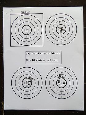

The targets in post #41 with the different lot of Midas+ show a very different pattern to my eye. Most show a good waterline that is roughly the diamter of the 10 ring or less, which is quite good to excellent at 100m/yd. There were a few outliers, but most of those show horizontal dispersion, which looks like wind, so I am wondering if those were wind-caused impacts and not ammo-caused fliers?
In post #41 target sheet #6 bottom left was the only bad vertical pattern, so I am wondering if that group experienced a switching swirling wind, or helical gust wind that can drive POI up or down?

There does seem to be excessive vertical in some of the earlier targets, but the vertical dispersion can't be explained by MV differences because the amount of dispersion is too great in the most egregious cases. A POI increase or decrease by one inch at 100 requires a round to be 40 fps faster or slower than the others.
I suspect that the MV spread will not be extraordinarily high and that the individual rounds that had higher POI's were themselves not unusually fast. The most likely culprit of such "flyers" (if that term will be allowed here) is bullet irregularity. This could be one of either imperfect heel shape or unbalanced bullets (offset center of gravity) or perhaps a combination of both. If MV's were not unusual, the chronograph would have offered evidence to support that suspicion (but of course not prove it).
It's clear that wind (or air movement at points between shooter and target) played a role in what happened on the targets posted today (and yesterday, too, for that matter). It's usually the case that there never is a situation when there is absolutely no wind. Most of the time we don't have enough flags out to observe it.
At my club's range, a small one that is 100 yards maximum and has a lake at the shooter's end and trees on either side and a long, sloping hill rising behind the targets, the winds are typically swirling and switching. Flags nearest the shooter can point one way and flags further out another. One can be limp and the other fluttering. It makes it difficult to read the wind.
Today when there was air movement, the wind was generally from right to left. This is indicated by a number of bulls showing some POI's drifting to the left. Unfortunately the wind direction wasn't consistent. Flags at different distances occasionally showed winds in both directions. At other times it was relatively calm.
Regarding the vertical in target 6 in post #41, the outliers may be due to winds as suggested. But there's no way to know for sure whether it's a wind result or caused by ammo imperfection or shooter-induced error.

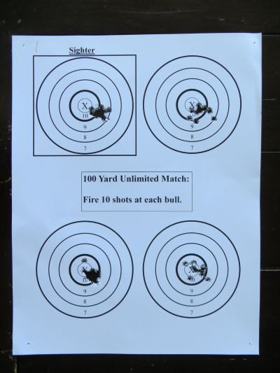

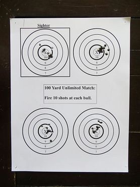

With the exception of one group out of ten (see the bottom right bull on the target below) the Midas + did better than either lot of CX. (I'll continue this later as supper's being put on the table.)

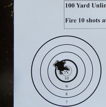

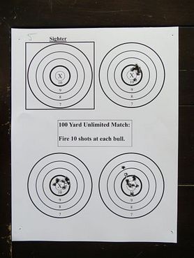

I shot the target below this morning. At under .600" the top left bull was a good start. The bottom left was going nicely and was looking to be similar to the other group -- until the tenth shot, which went high. (It always seems like it's the last shot that screws things up but that's only because everything is going well until then.)
I was chronographing this lot of ammo and tracking the POI with MV. Curiously, that tenth shot on the bottom left bull was not the fastest round of the group's ten. The ES was 22 fps for the ten rounds, from a low of 1035 to 1057 fps. That tenth round had a muzzle velocity of 1037 fps.

Thats some dam fine shooting and Im thinking your a bit generous in measuring!! Im pretty sure the calipers can just touch the smudge. No need for the spaces your leaving. It is however rather refreshing to see REAL target measurements rather than some of the fictional ones posted on the different forums. Wonder if they actually believe it themselves? Anyhow very well done, really like that wallet group Im gonna says actually more like 0.658-0.660.

Thanks, Chris. You're right about the sizes of groups that sometimes get posted. Some are quite literally incredible, as in hard to believe.

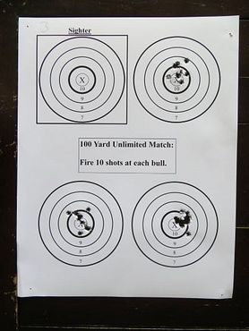

This morning it was very calm so I went to the range. I shot two boxes each of two different lots of Midas +. While the targets included a few small ten-shot 100 yard groups, what really caught my attention were the flyers. Each target page had at least one flyer spoil There were enough flyers in both lots that they every so often that spoiled what were in many cases otherwise promising groups. This suggests variation within the lots that makes them too inconsistent to produce reliable results.
The top row shows ten ten-shot groups with the first lot of M+. The second row shows ten ten-shot groups with the other. Some scope adjustments were made during shooting of the first lot.
In both sets, the first target shows the best and worst of each lot.
