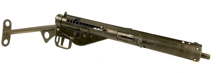

In the bottom photo on p.48, note that the main casings have not yet had their triggers guards welded in place.

A Sten will function with its extractor removed. Better with it installed.
I suspect that the business about ammunition compatibility is a bit of bumpff.
Sten parts production was extremely diversified. But final assembly occurred in large facilities - ROF Enfield, BSA, ROF Theale. I suspect a bit more disinformation.
Can anyone verify this statement in the article: "But in order to prevent the enemy using captured British ammunition, they designed the rim of the cartridge that it cannot be gripped and ejected by the extractor of the German gun." Or was this placed in the article so German agents would read it and past the information on to Germany where a directive would be sent out from Wehrmacht HQ telling the troops that British 9 mm ammunition is defective and cannot and will not be used in German weapons.
I know the mechanics of the auto STEN - has anyone encountered the drawings for a semi? Semis are usually a tad more complex, I'd like to see how they tackled it.
