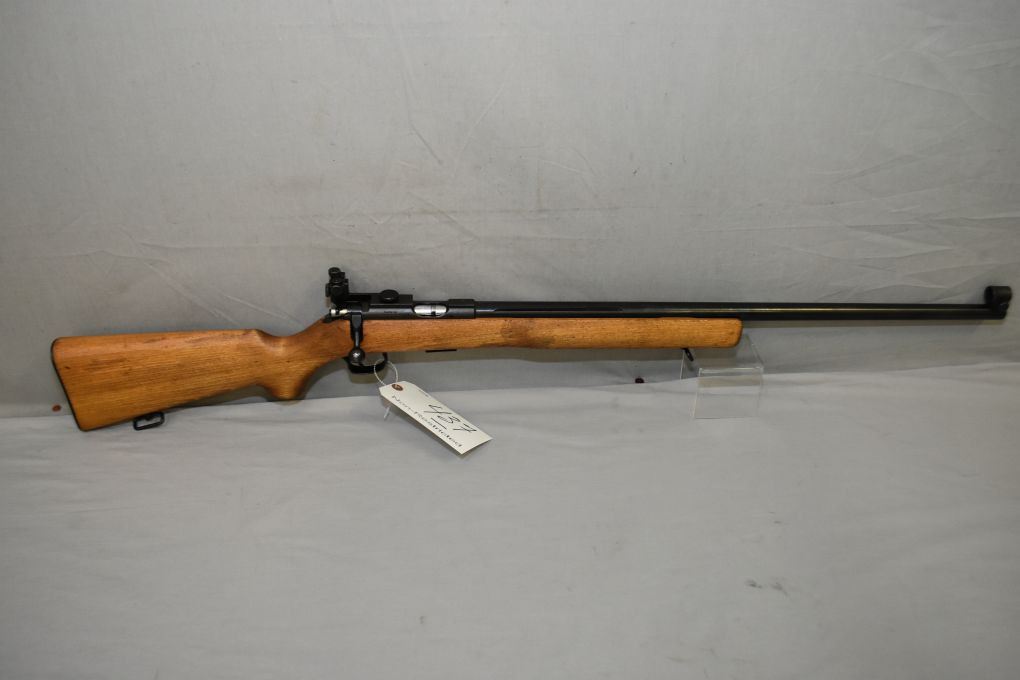

I run a CZ452 in an Aeron stock with two slabs of cold rolled steel screwed to the fore end to get the balance right, (because the barrel is not long and heavy enough) but I would much prefer a longer heavier barrel like this old BRNO target rifle. A buddy of mine happens to have one and I would trade him in a second.
