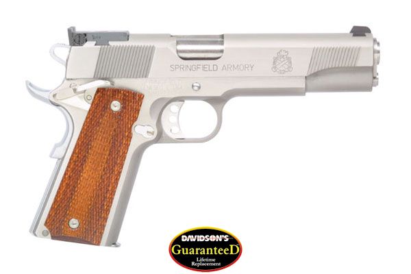

I have just bought Springfield 1911 A1 in .45ACP, single stack/7 rounds. I hear that there are some extended mags I can go with and also I can install mag well or something like that for quick mag change.

This my pistol:
