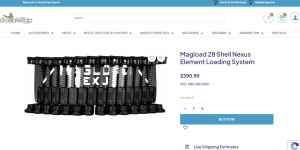

They are not made anymore and caddies have progress far beyond the 086. Its either MagLoad or King nowadays.
