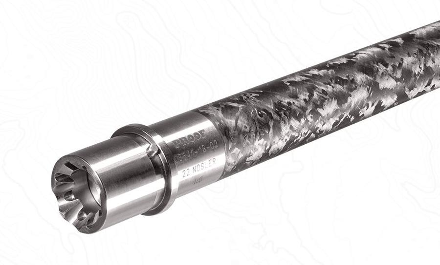

IRUNGUNS now carries Proof Reasearch barrels
IRUNGUNS

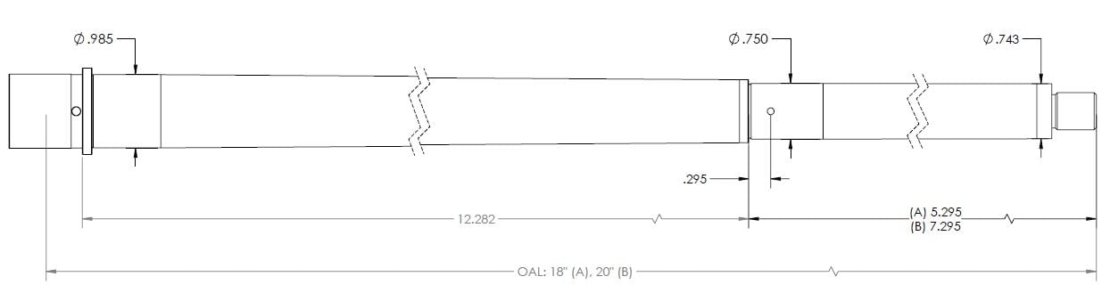

Unless I'm interpreting it wrong, their barrel profile diagram seem to indicate their barrel lengths are taken from the bolt face. This shows what it is for their 18" and 20" barrels:
I dont know what the deal is exactly, but I had a firearms verifier confirm my above statement on a BLI imported proof barrel back when I was planning a BCL102 build that has yet to come to fruition. BLI did not order anything special, so I am doubtful this is a coincidence that their batch just so happened to meet the legal requirements for NR status.
