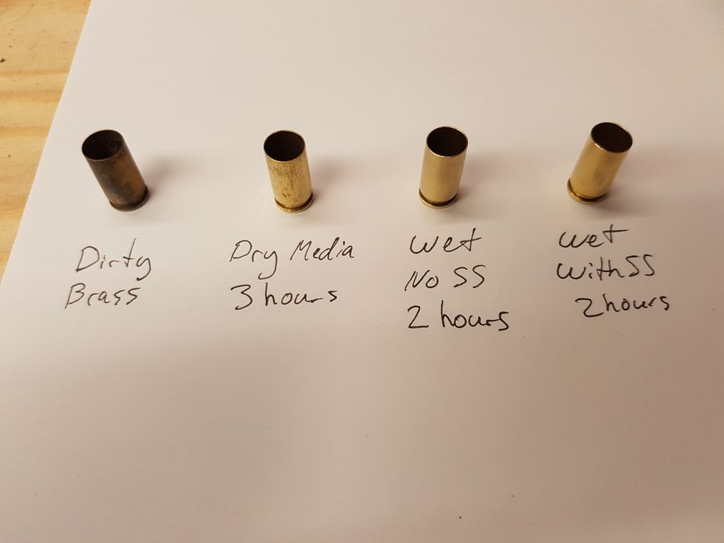

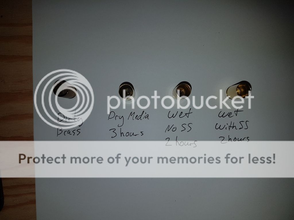

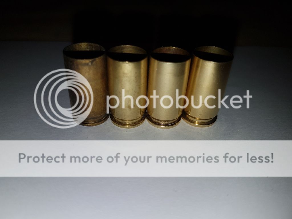

Here are the results.
Dry Media is the Lyman Turbo Treated Corncob with a tsp of Nufinish Car Polish.
Wet Media is 2 tbsp of Dawn Platinum and 1 tbsp of Lemishine.
The Frankford Arsenal manual even says to run the brass through without the SS pins so that they're clean when you deprime, then run them through again with the pins to clean the primer pockets.
As you can see, without the pins, the insides of the case won't come out shiny like the outside. All in all, it's a nice little machine and worth the money in my opinion.

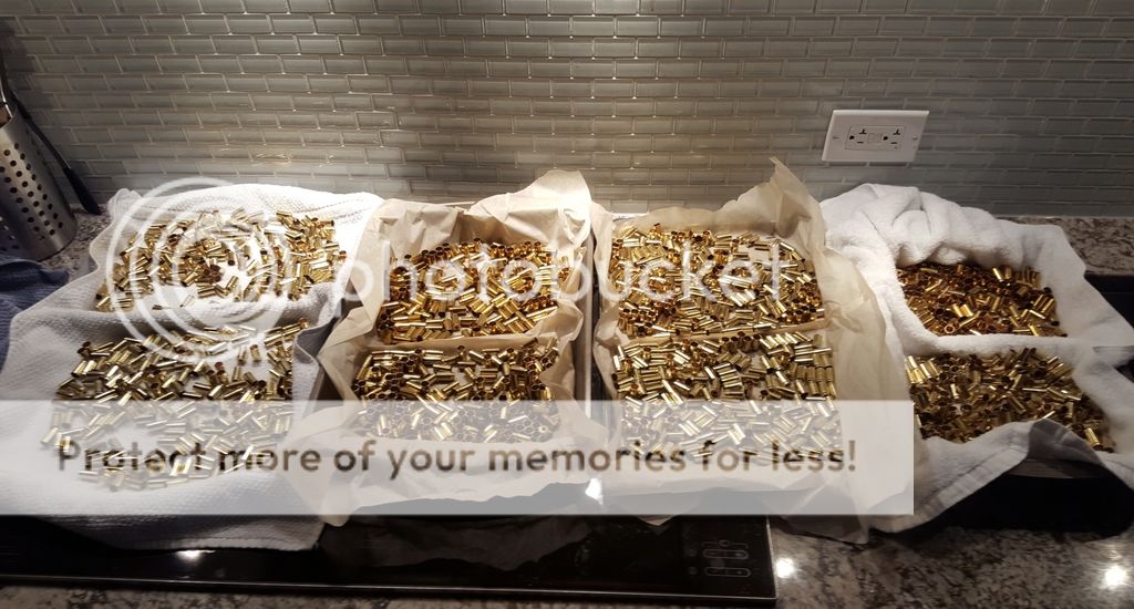

Here is a picture of all the sub batches. We can tell already a different in color between some of them.
Its hard to tell the difference between them so i grabbed 5 brass from each batch and took pictures using the same lighting.

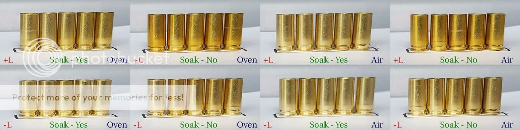

Here are the picture organized by 2 categories. By comparing the top row with the bottom row, we can tell what variables are most important to get the right brass color:
Organized by amount of lemishine used (top more lemishine, bottom less lemishine)
As we can see here there is a big difference in color between the top and bottom row. With 1 tsp of Lemishine we get a lot more orange in our brass compared to one 9mm cap of Lemi.
The exception here is that if we soak them in lemishine (1nd and 3rd column) after the wash, they return back to a brighter color.
So the conclusion here is that too much Lemishine will turn your brass orange.

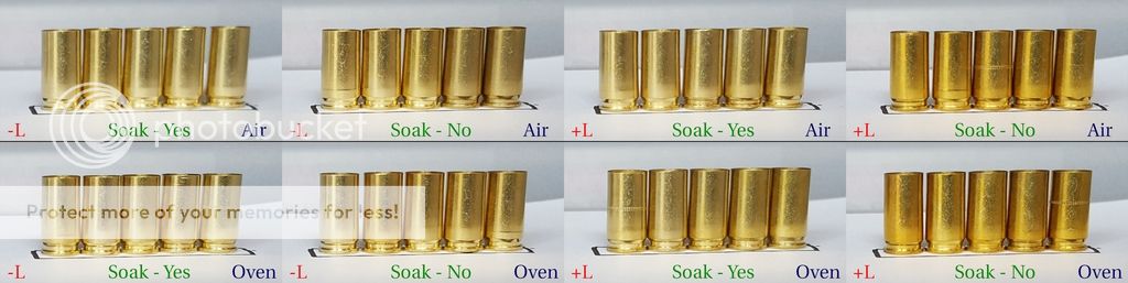

Organized how they were dried (topair, bottom oven)
Here we can see there is not much difference between the top row compared to the bottom, meaning it doesnt really matter how you dry the brass.
My conclusion is that one 9mm cap of lemishine is more than enough to make them super bright, too much will turn them orange.
The drying method doesnt affect the color of the brass if you dry them in the oven at 200F (maybe at higher temperatures we would start seen a difference in color)
Soaking the brass in hot water and lemishine for 20-30 min will make your brass brighter/whiter but is not a huge big difference (as long as you didnt put too much lemishine, if you did you can soak them to remove the orange color).
