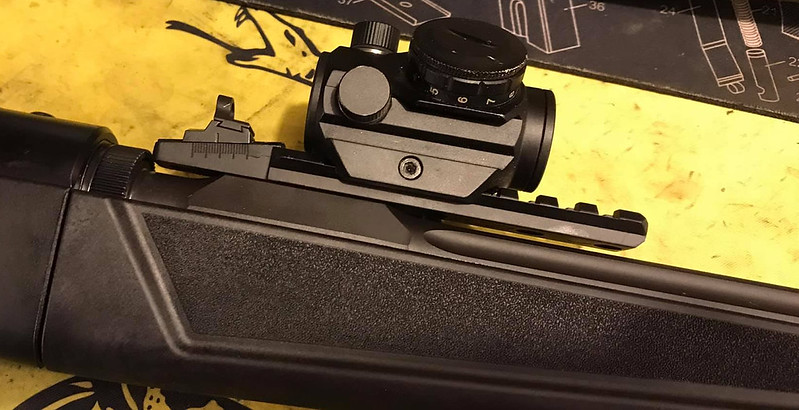

Regardless, I'm looking forward to trying this red dot mount out tomorrow. Being barrel mounted, take-down shouldn't be an issue.
https://flic.kr/p/2m33VBa https://www.flickr.com/photos/162118399@N03/

Never measured, but I have seen it. Maybe an inch or two at 50m from what I remember? It's not a big "distance", but it's not zero. Pressure on the fore-end, like from leaning into a bag, can make a significant deviation as well.
