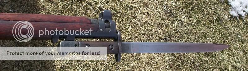

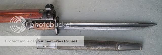

IIRC, the Indian pattern bayonet with square pommel and shorter flat-sided blade would be correct? I may be totally off here.
Lou is right. Timberlord that is one of the best 2A1 rifles I have seen. Most of them were very well used and showed it. I bought one from P&D at a Kamloops gun show shortly after they came out. The best they had would have rated GOOD only. Even then, they were pricey.

The cut down Indian Mk1 bayo . This one "was" a Vickers P07
The Indian Mk11. No bloodgroove
Note the smoothed edged P07 handle,,,some later bayos will have handles that are more squared
