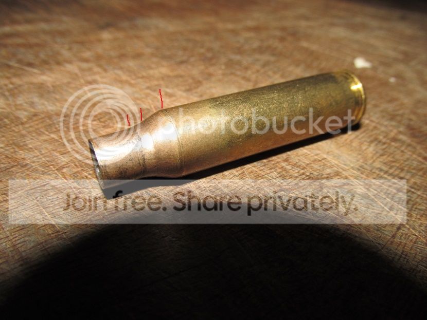

hope this helps.
Notice the Neck, and 308 shoulder. common?
line arund or just below shoulder also
Whenever I see lines like that on brass, the one closest to the base, I toss them..could separate on you. Ive never seen them that high but have had case head seperation before and those lines are the warning sign.
Cheers!!
