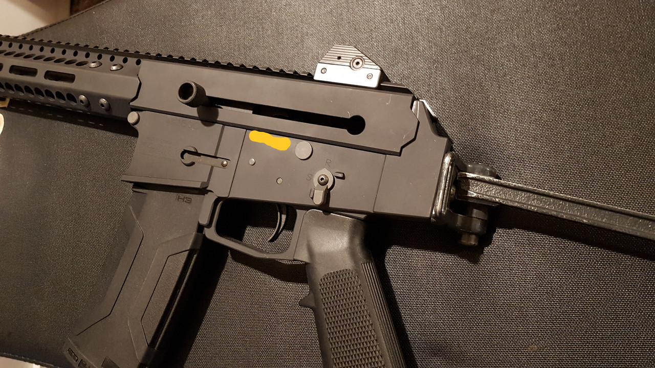

A short Galil stock or Vz stock were the other option I had considered. With that in mind, I pulled the stock, and created this.... thing :)

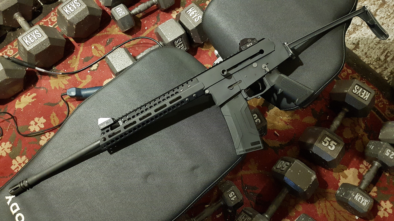

BEHOLD, the hybrid Vz180C.... Vz stock and irons, with a Canadian rifle!
This stock fit so easily that I'd almost have thought Wolverine designed the rifle with it in mind. The indexing tab at the top of the stock needed to be filed slightly. Add a washer, use the factory WK180 bolt, and done. Cheekweld with the Scorpion iron sights is almost perfect.

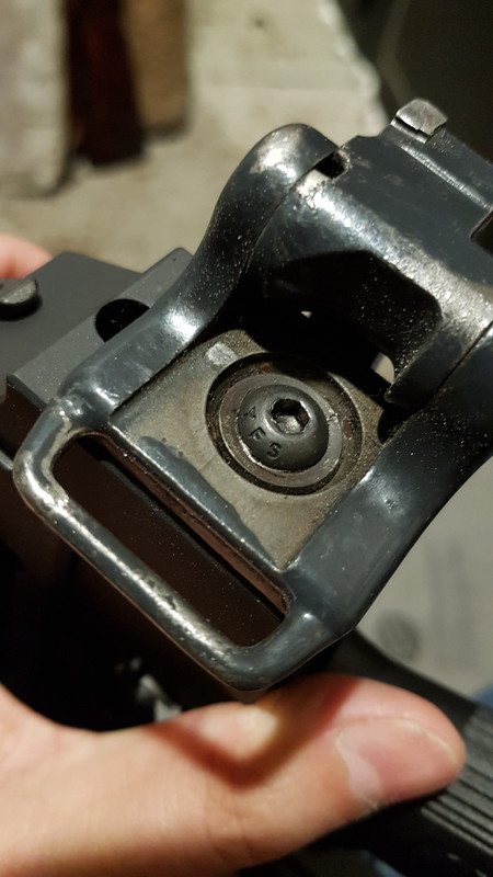

Just waiting for buffer tube wrench to take the castle nut off of my WK180C. Might build an adapter as both factory stocks use a countersunk screw. While I could "bridge the gap" using the WK180C factory stock screw I want to get it as tight as possible.
Considering building an adapter plate to accommodate the raised protuberances on the factory stock which match a slot on the CZ to prevent rotation of the stock during "rough" use. Not sure I want to machine the receiver of the WK180C for the slot (although this would probably be the easiest.

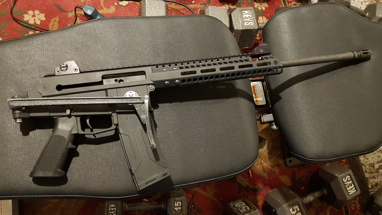

Here is a mock-up of WK180C with factory AR setup and my "improved" CZ858 stock.
And another zoomed out a bit. Changes the look of the rifle quite a bit compared to the bare skeleton stock. Might just clear charging handle when folded.
I am hoping the added length and heavier folding stock will rebalance the rifle from nose-heavy to somewhat balanced. Not that happy gaining overall weight. Compromises have to be made I guess. Recoil might be mitigated somewhat due to the stock axis to barrel axis differential. B

So I have the prototype on the rifle.
I'm close, but have to open up some dimensions to allow for some play/ease of installation/alignment.
Likewise, I have to angle the lower portion to match the angle at the bottom of the receiver.
So close.......
Discovered the limitations of rapid prototyping. Can't tighten the screw sufficiently to determine how solid the offset screw adapter will work to secure the stock to the receiver. The dowel pin doesn't do anything either.
Due to the 20% infill of the PLA material I hear "crunchy" noises every time I try to tighten the screw.
Same result when I mount the rifle to test the length of pull and general eye alignment with the scope. Was worried about the extra length of the stock but it is a moot point - it fits nicely and feels more natural than the CZ it came off of.
The offset may be too much for the stock and the 1/4-28 screw given how the screw is lowered which results in a greater moment on the 1/4 screw which may/may not be sufficient (See below)
You can see how the lines "flow" between the receiver, adapter, and stock - hence the offset screw. Was trying to go for an OEM look that didn't scream "bubba" (not that I'm judging anyone").
This shot shows a better view of the transition between the parts - it is close to the final form - Just need to make it out of metal to determine how sturdy it will be in the final configuration.
Note - that in folded form the bottom of the stock lies "parallel" with the bottom of the receiver lines. Misses brass deflector and still enables actuation of safety. May have to remove magazine extension button as the stock "leans" into it when folded - and dumps the magazine when "pushed". Can't tell if this is an artifact of the "squishy" pla material which hopefully will not be duplicated when done in aluminum.
