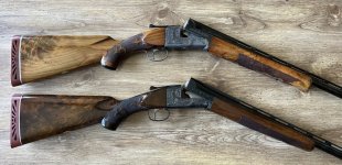

The long 2" choke sections with .036 constriction likely explain the complete and utter inkballing of targets with the 1oz AA #7.5 loads with an advertised mv of 1180 fps. Obviously a deadly choke/load combo for these guns. The recently acquired '63 Knick is the top gun in the pictures and all original except for the later aftermarket high-viz style muzzle bead which I will swap back to an original Ithaca raybar sight to match my '57 to give me an identical sight picture for a back-up gun.

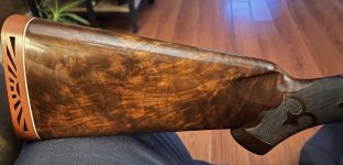

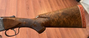

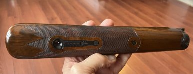

Neither are slouches in the wood department for sure. I don't see many Knicks with the more blonde wood with reds in them. This is the wood on the top one...
View attachment 1175085View attachment 1175086View attachment 1175087View attachment 1175088
And this is the bottom. My preference is the bottom. View attachment 1175079View attachment 1175080View attachment 1175081
Top wood looked better in the first Pic set. The 2nd set of photos I agree the darker looks better.

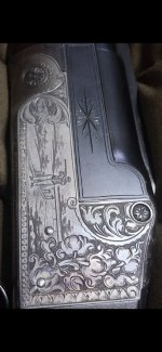

No not all have a T. I have a Knick with a T and from what I can ascertain a T at the end of the number is pretty rare. My 1957 4E Knick is also signed by Bill McGraw the engraver which is also a rare thing. He didn't start signing some until the late 50's. The engraving though hand done was done in house by a few different engravers and was considered "generic" as each grade had it's own identical pattern yet a close up look will reveal no two are exactly alike. Each artist changed little things here and there. McGraw was an engraver right from the early days and stayed until his retirement 50+ years later from what I've read. Bill Mains was another engraver who occasionally signed his name to his work. Ithacas with engravers names seem to be more in demand due to the nature of very few guns having been signed. And they knew how to hide their names in the engravings. It took me months before I located it on my Knick.
