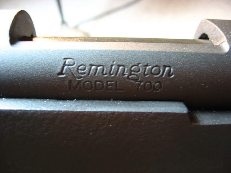

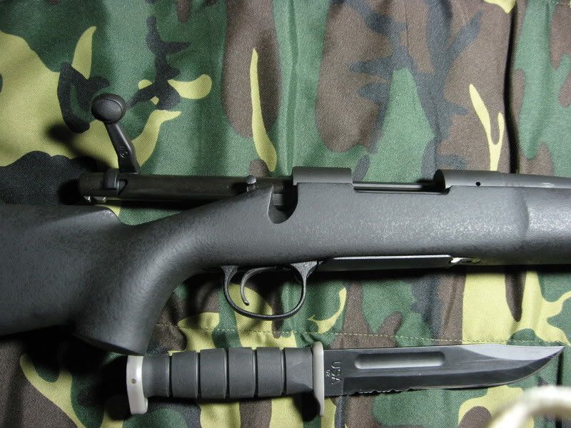

Well here are some pics (I know, it's "just another Remington 700 Police, big deal", but to me, it's the prettiest rifle out there! Not the greatest lighting though):

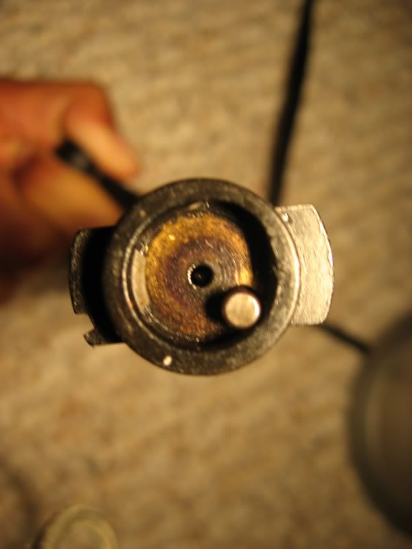

Is this rust on the bolt face? Or is it some sort of grease/oil?
-Rohann
Hell, mine didnt come like that. Actually, it's fired around 300 rounds now, and it isnt even close to looking like that. I hope for you it's oil.Maybe soak a Q-tip with DW-40 and try to wipe it away gently. If it goes away, it's most probably oil.

Often you will find the bolt face on a new rifle with brass on the bolt head.
This comes from the proof rounds.
However, it would have been nice of it were cleaned off before it was sold to you!

I also cleaned the bolt head with a patch and some Rem-oil and it looked clean, so I'm guessing it wasn't rust.

Im guessing you cycled some rounds through it and you have some brass dust on the bolt face. All the edges will be pretty sharp right now so you are going to get some brass shaved off when you cycle and extract rounds. As you break it in it will go away.
On my LRT I just made up a few dummy rounds and cycled them through the gun from the magazine. That will help break it in and round down some of the sharp edges.
