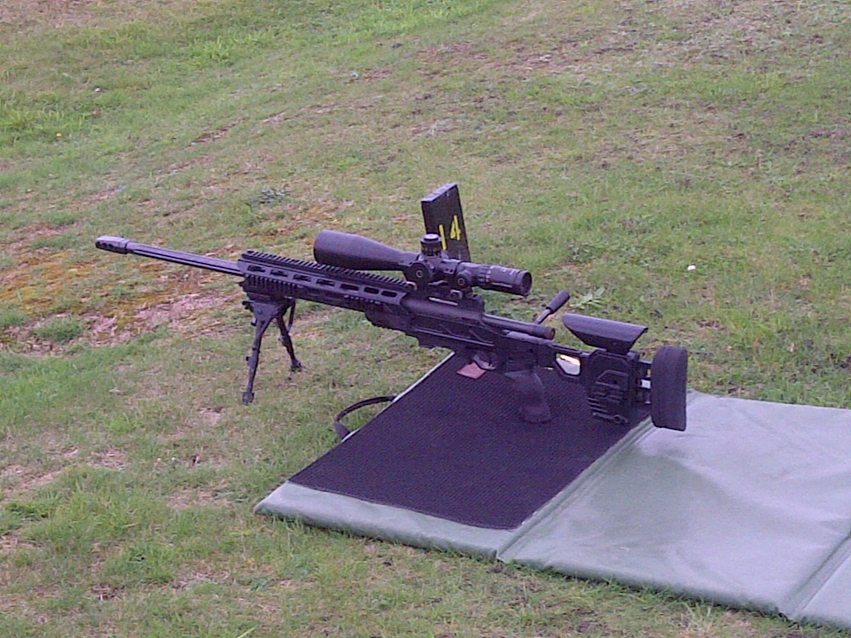

its like christmas.. SB mount advice

S&B in the Cadex one piece mount. ;)
Does it have any moa built in?When I mounted the S+B I used for the Tactical shoot last summer,with a 20moa rail I was still in the top end of the comeups.I'm guessing to get the most out of it you would probably be best to use a 30 or 40 moa rail.
The Unitized Scope ring doesn't have any built in MOA. The chassis above does.
SB recoments useing a mounting system that is equal to 1/2 the MOA in the scope, ie a 65moa internal set up, use a 30moa rail, a 75moa set up use a 40 moa
I use a NEAR Mfg. 25 MOA tapered base.................however 30 MOA is recommedend.........
For those asking about 34mm rings, I went with Badger Ordnance Maximized High rings to clear the 56mm bell on my S&B.............If I couldn't get badger, I would have went with TPS rings.......great bang for the buck with TPS....... ;)
