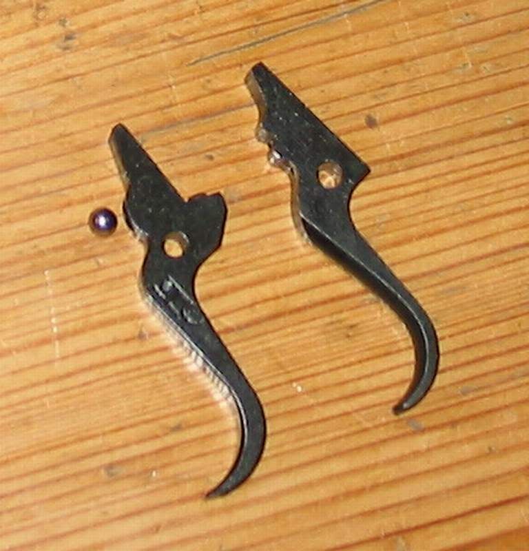

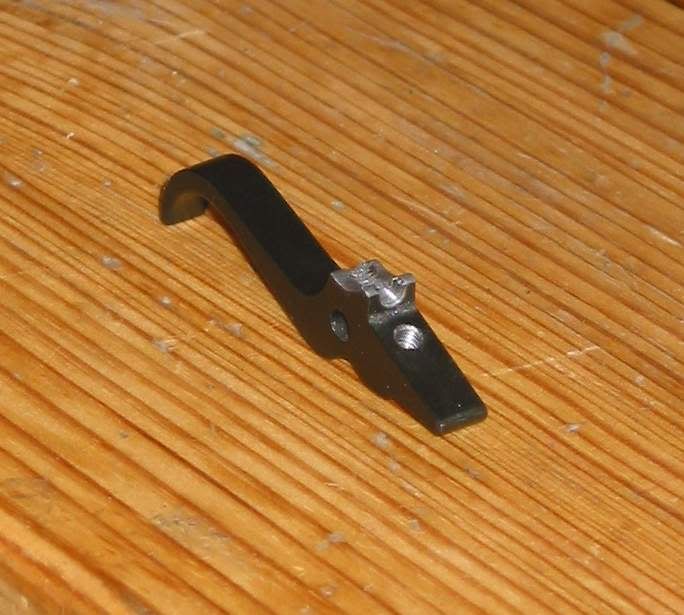

OK, so once again here is a Pic of the origonal trigger next to the Huber Concepts Trigger:

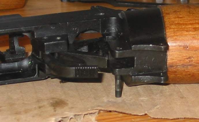

This is what I had to get the Huber Into:
The Solution!! Once again my Trusty Canadian Tire Drill press has proven its Worth:

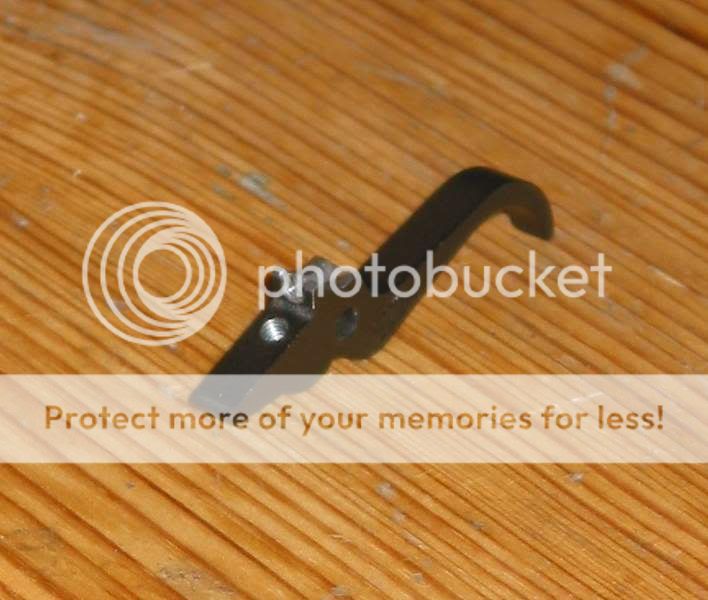

I Basicly just took one pass off the back of the trigger as you can see in this Pic:

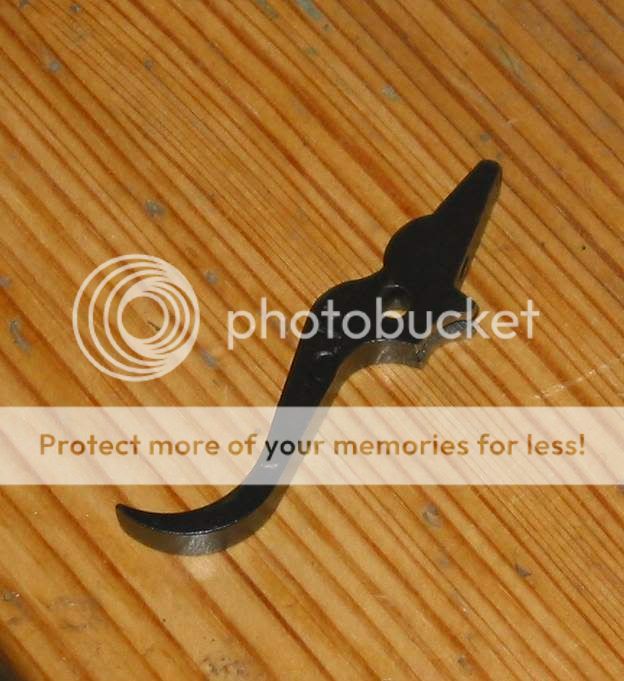

There was about a 1/16" of metal left stickin out which had the Reminence of the Creep Adjust screw hole in it. I Cut off the back area with a set of side cutters and from there just filed everything smooth. It's hard to know what I mean as I'm not describing it well but you'll see it in the pics:
The remaining material on the back of the trigger worked as a permenant, non-adjustable creep eliminator and I just adjusted the trigger for pull weight. I don't have a Trigger scale but I'm guessing its about a 1lb or under pull and breaks so Clean it could make a guy Cry! It has Improved my Shot groupings already but seeing as I don't have a good bench (or a good shot for that matter :lol:) I can't tell exactly how accurate it is =-) I'm Pullin off 2" groups at 150yds shakin like a Knight in a Thunderstorm.

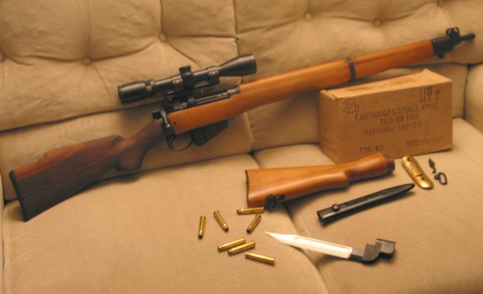

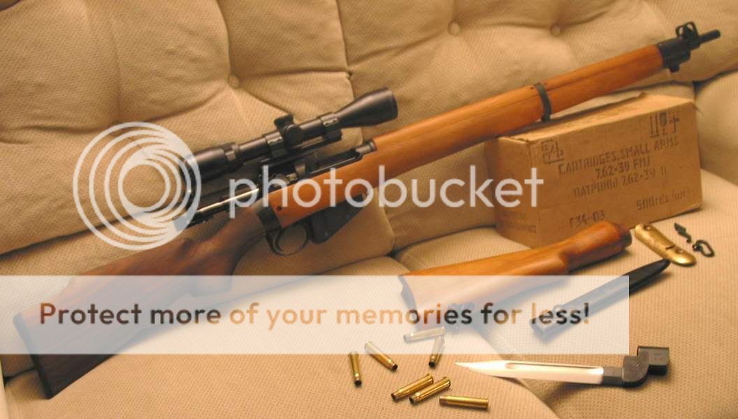

Here is a Pic of the Finnished Product, Monte-carlo stock and all:
Now I have to ask you "Anti Mod" guys, Is it really that bad? I Mean... Really? 100% reversable, old battle rifle gets a breath of fresh air. You Like it, Admit it :D
