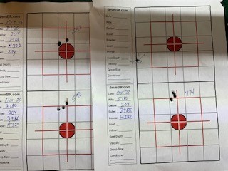

Well i loaded up 50 rounds and went to see how the J180 would shot. it all worked good, sighted it in and it shot .5" 3 shot groups @ 100y. the next thing i need to do is clean up the trigger, it is one of the nicest out of box black gun triger at 3.75 pounds, but is long. so far so good pics coming.
