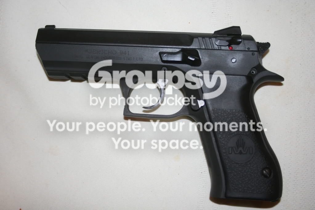

Might as well put a pic up to see if this is the gun you're talking about?

That's the one. Baby eagle. :D Very nice gun. :) I will run a fresh batch of reloads (say 20rounds) and try them with your information and see if it cycles through.
