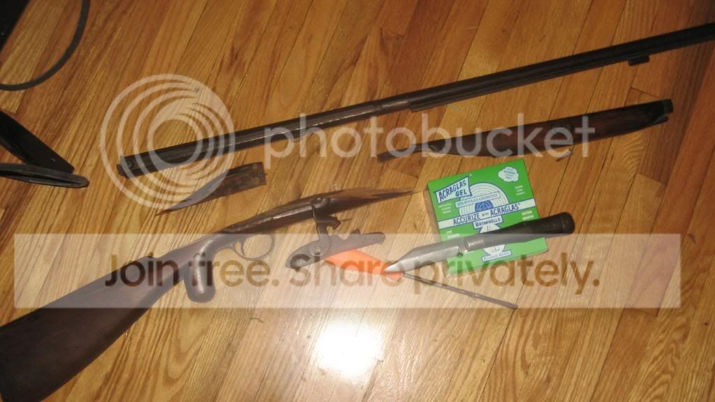

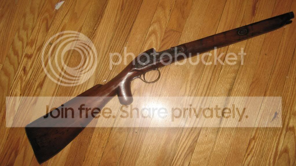

I traded for a jezail a few months ago and finally had time to take it to the range. This one has a 45" rifled damascus barrel about 53 caliber. Somehow I succeeded in forgetting my powder measure and had to use an improvised one. Principle charge was a nagant rifle shell of 3F which turned out to be about 55 gr. That seemed kind of wimpy (because a lot was leaking out the touch hole) so I increased that my charge by an additional sks shell of 3F which brought my charge up to about 72 gr of 3F. When I realized that the touch hole was a bit Reubenesk, I plugged the hole with a vent pick and cut back to 55 gr.
I used a .515 ball and .019" patch and the gun seems to shoot fairly accurately. In the target below, my first two shots were aimed at 6 o clock on the bull and struck slightly low and 4" left. I changed my aiming point to the top right corner of the bull and put 5 shots in roughly 2 1/2". Final shot was way low and left again, I think because I chafed through the patch in loading. After shooting I found one intact patch and several that were totally destroyed so today, after cleaning the gun I ran a tight patch coated in coarse valve grinding compound up and down the bore and hopefully that has smoothed some of the rustiness down a bit. I am most curious how well the gun will perform on the next go around
