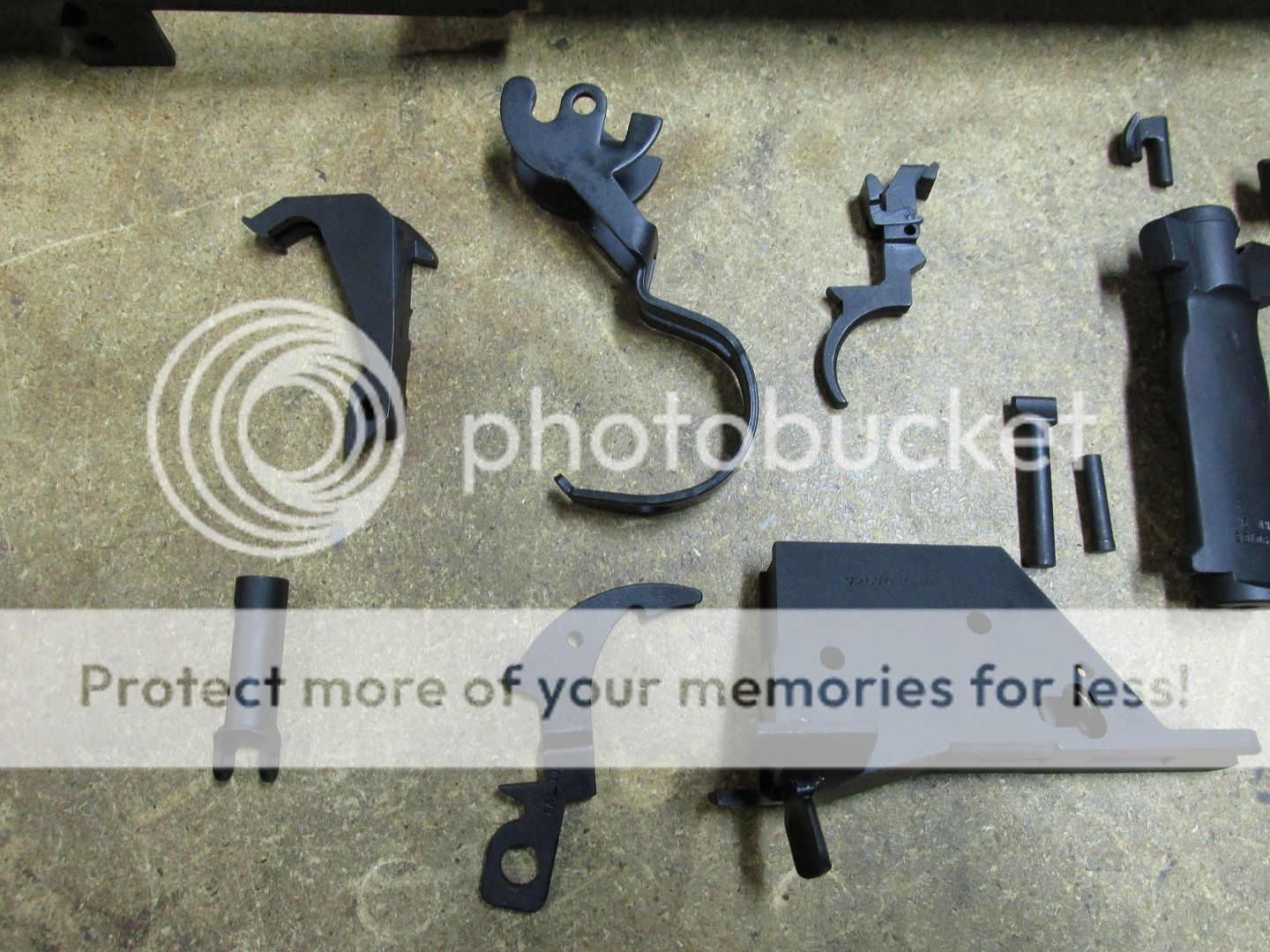

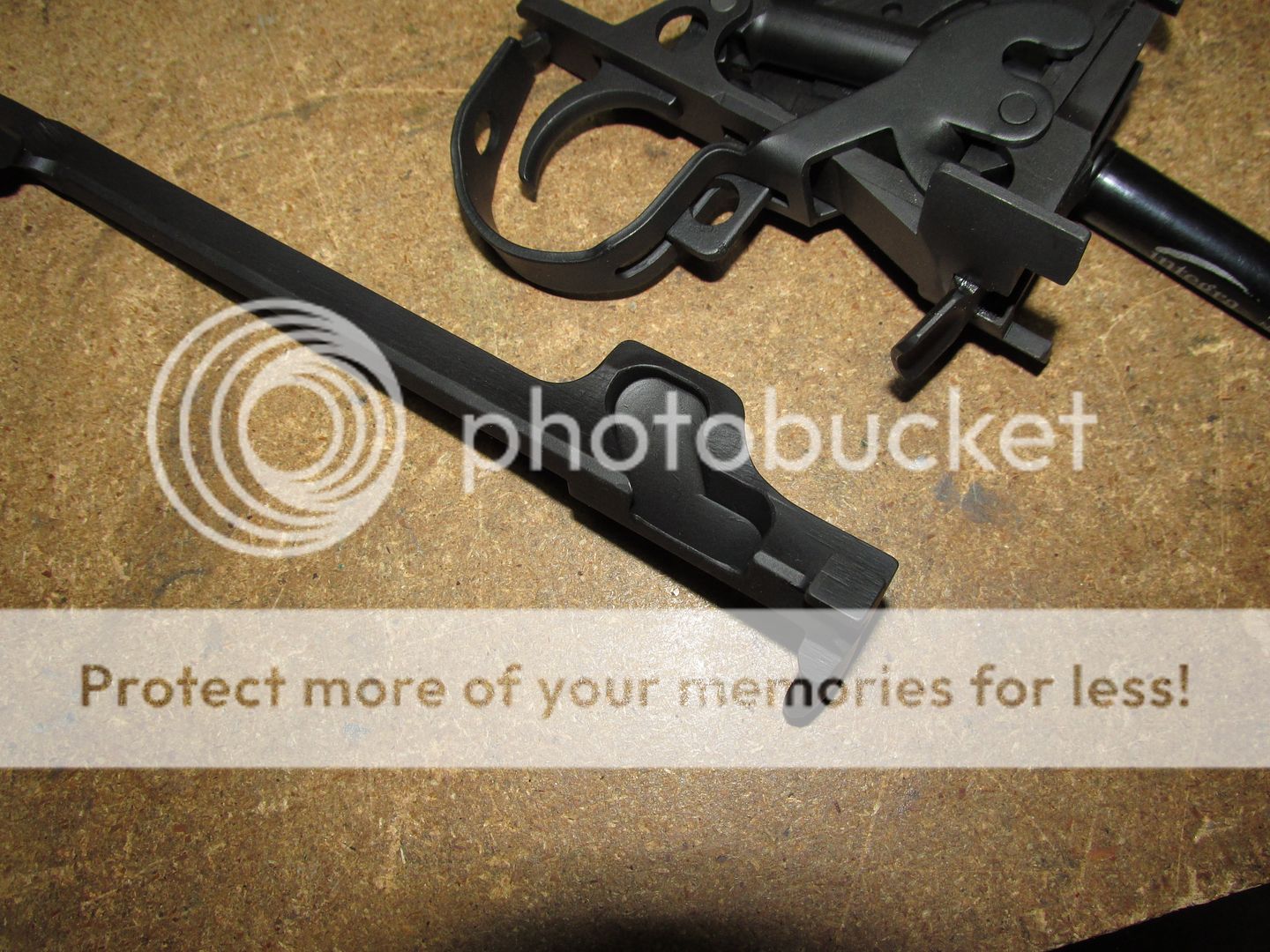

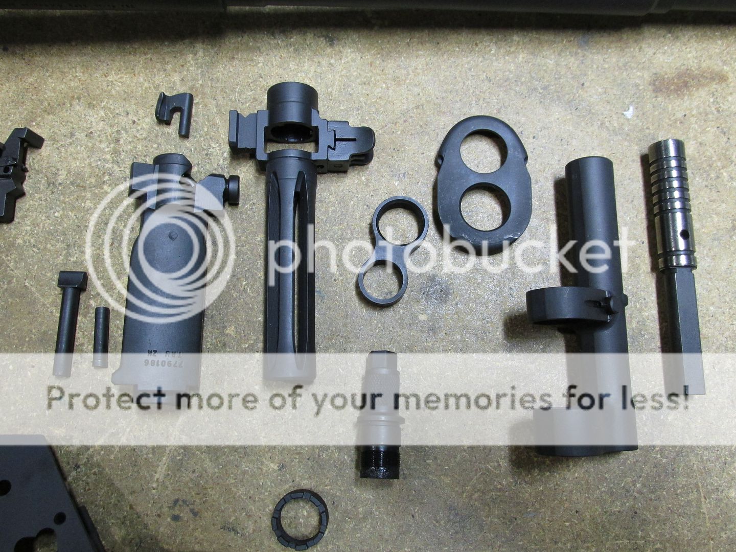

While I was getting ready for my deer hunt, I sent off a bunch of parts to have his salt-bath nitride treatment. I absolutely love the finish of these parts! I sent everything but the receiver, rear sights and I forgot to send the bolt stop and the clip guide. I'll fit those in on the next batch.
The barrel is one of his 5R/20 barrels that I built my T44E4 receiver with and the rest of the parts are from my old M1A standard that I stripped off the action to build my T44E4. All the parts were used GI parts with the exception of the bolt. The Bolt was an arsenal repack. I built the rifle first, cut the chamber to desired headspace, polished the chamber and lapped the bolt lugs to the receiver.

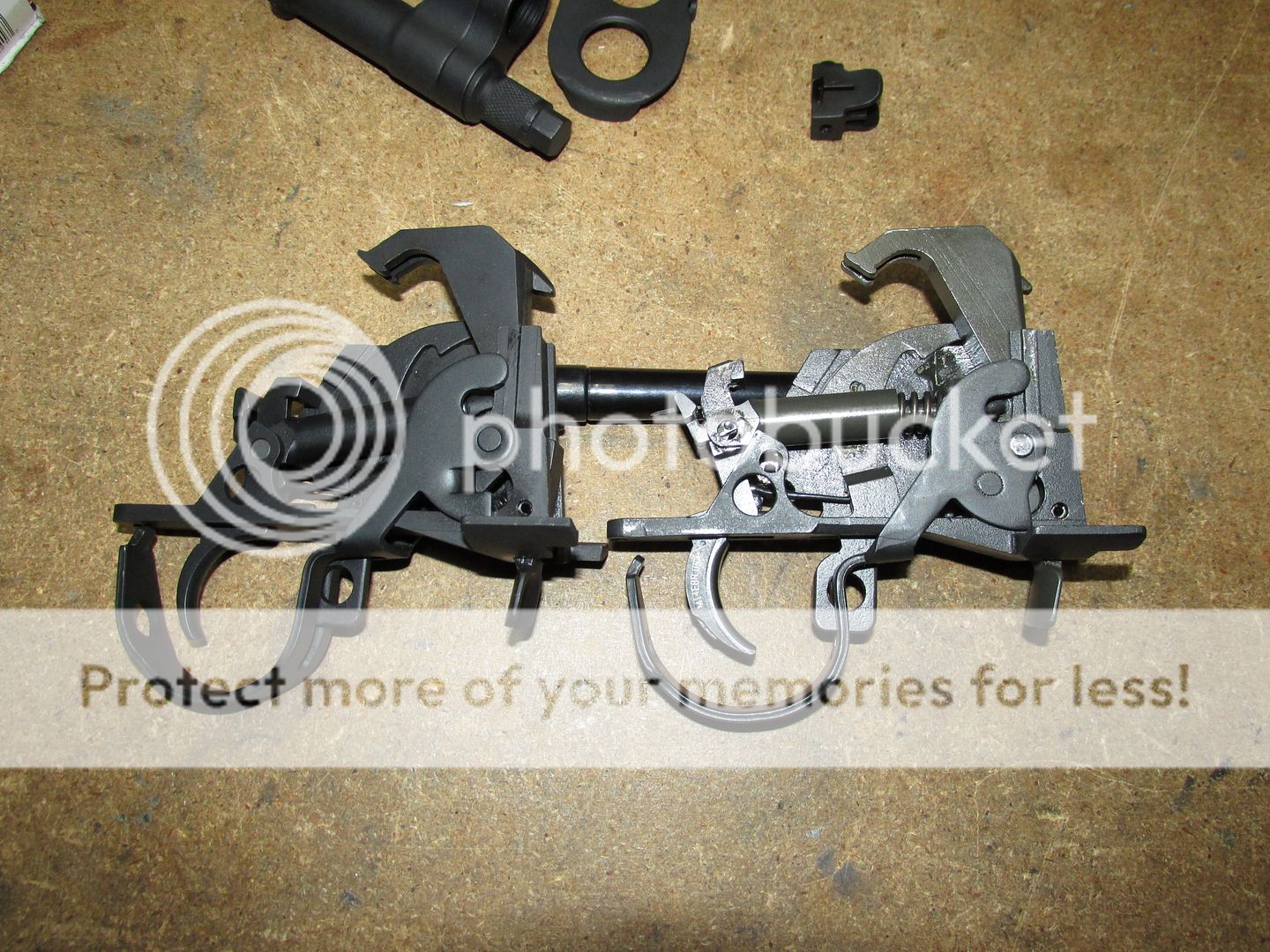

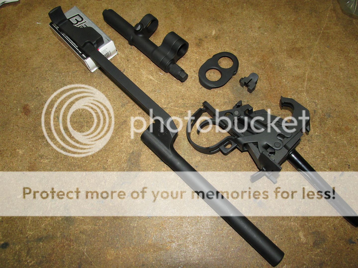

Before...
After...

I'll do some comparisons with my M25 which has the un-treated 5R/20 barrel and the same headspace cut with the same reamer. I'll compare velocity, accuracy and cleaning results. I broke in my barrel and Jon said it was perfect before he treated the barrel. Since these parts came off a used M1A standard, the gas plug and piston already had rust and pitting before I sent them in. The process eats away all the rust from the surface, so there is a rough appearance on the parts that had rust. They were serviceable though and the rust should be stopped now.

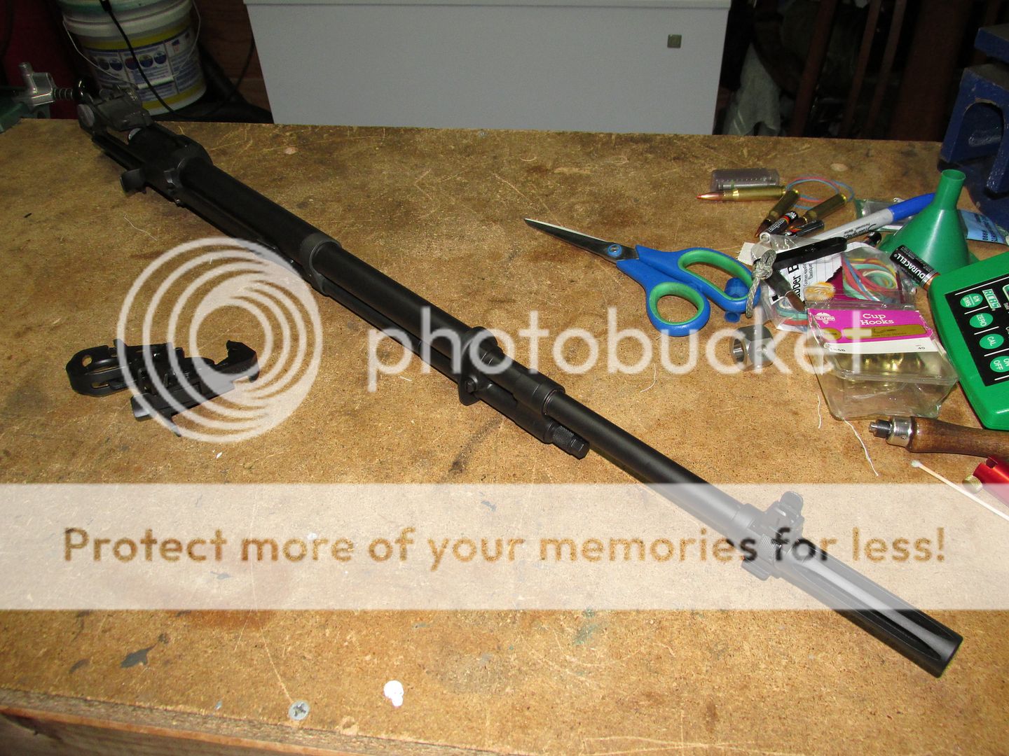

I already installed the barrel and timed it perfectly. I'm just waiting on an operating rod guide and a hammer pin to finish the rifle again.

Before...
After...
