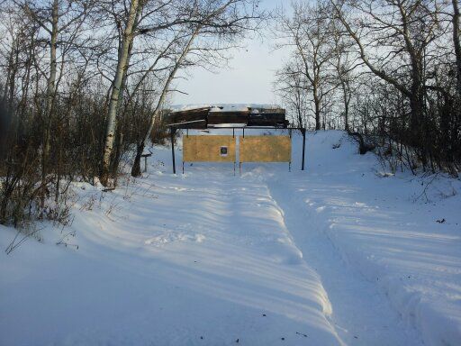

cold windy day at the range

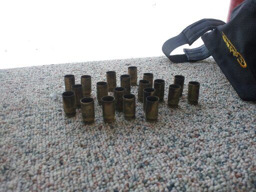

I just got back from the range, before going out I polished the feed ramp and completely disassembled the rifle right down to the firing pin.
I have to say I really like how easy this rifle is to disassemble into components.
Battery for the red dot? check! Brass catcher? check! ammo, target, rest, yup gtg.
http://s1048.beta.photobucket.com/u...359412544698_zps2b5c09a3.jpg.html?sort=3&o=16
http://i1048.photobucket.com/albums/s373/koskelacrue/th_1359412578212_zpsa3e469f5.jpg
http://i1048.photobucket.com/albums/s373/koskelacrue/th_1359413598499_zps675aa94b.jpg

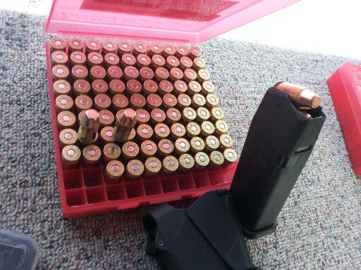

All set up for some shooting. Using the truncated cone because, well I got a whole pile of them and if it works with them it will work with anything.
http://i1048.photobucket.com/albums/s373/koskelacrue/th_1359413209991_zpse1bedd80.jpg
http://i1048.photobucket.com/albums/s373/koskelacrue/th_1359413219719_zps39808393.jpg
http://i1048.photobucket.com/albums/s373/koskelacrue/th_1359413152065_zpsa8f0fd9b.jpg
First 20 rounds no failures or banged up brass. I took some more carful shots at the corners every few magazines. All corners are 10 shot groups.

No FTF with the truncated cone bullets. no damaged brass. I will keep it for now.
