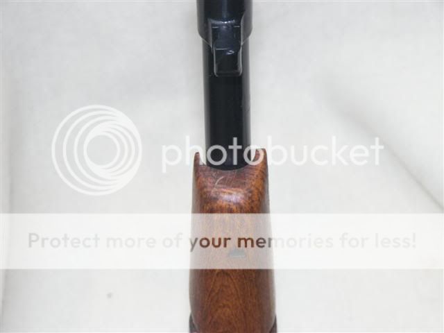

So I picked up a slightly sportered No. 5 this weekend at the Lumby gun show. I thought it was a good deal for $90
The good: Excellent condition metal, MINT bore, matching numbers, and a 5-round magazine (scarce, from what i've heard)
The bad: Sporter'd forend, missing butstock and missing flashhider.
I am pretty sure the barrel is uncut. The barrel narrows where the flashhider would be, and there is a different front sight assembly installed.
So, I came across a "No. 4 MKI To No. 5 MKI Jungle Carbine Conversion Kit" from Numrich for about $60. It includes most of the bits i would need, less a stock band and receiver ring. Apparently it uses converted No.4 wood.
My questions are: does anyone have experience with this kit? and how easy is it to pull a sporter sight and remount flash hider assembly?

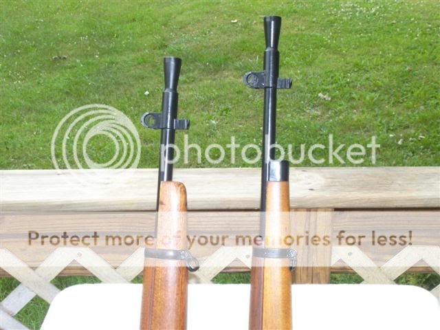

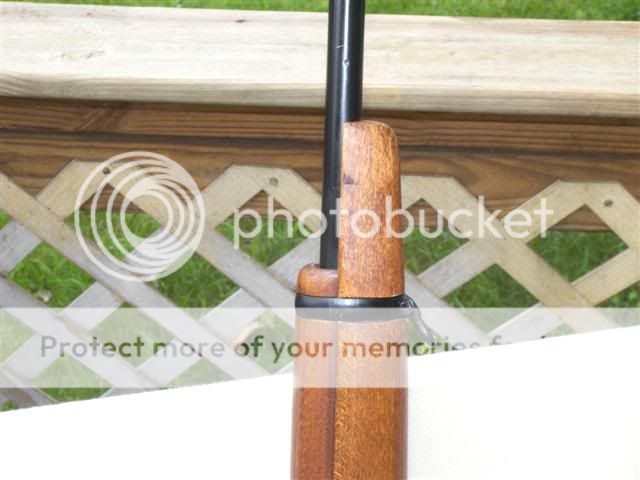

I converted a cut down No4 Mk1* last year with a Numrch kit. At that time they did not have the butt stock, so I only got the forearm, hand guard and flash hider from them. The wood is converted from N04 wood and it required a good deal of work to get it to fit properly. I don't think it turned out too bad, all things considered.

I managed to find a complete wood set with all the additional metal bits, thanks to a fellow CGN'er. I removed the sporter front sight and all I need now to finish this project is a flashhider. Anyone have a No5 flashhider lying around?
Update:
I have found a flashhider for this rifle. There is one small cosmetic issue I would like to fix. The flashhider is blued and quite pitted. So much so that it doesnt really match the rifle (excellent shape with suncorite).
Is there any way to fill pits? Is there a special method of soldering them? I would like to clean up the pits and find some alternative to suncorite to finish the flashhider. Any ideas?
Not sure about filling the pitting, but I've heard that BBQ paint is pretty good as a stand by to fake suncorite. I used flat black rustoleum spray paint on a couple of my No5s more tarnished bits, and am pretty happy with the results.
