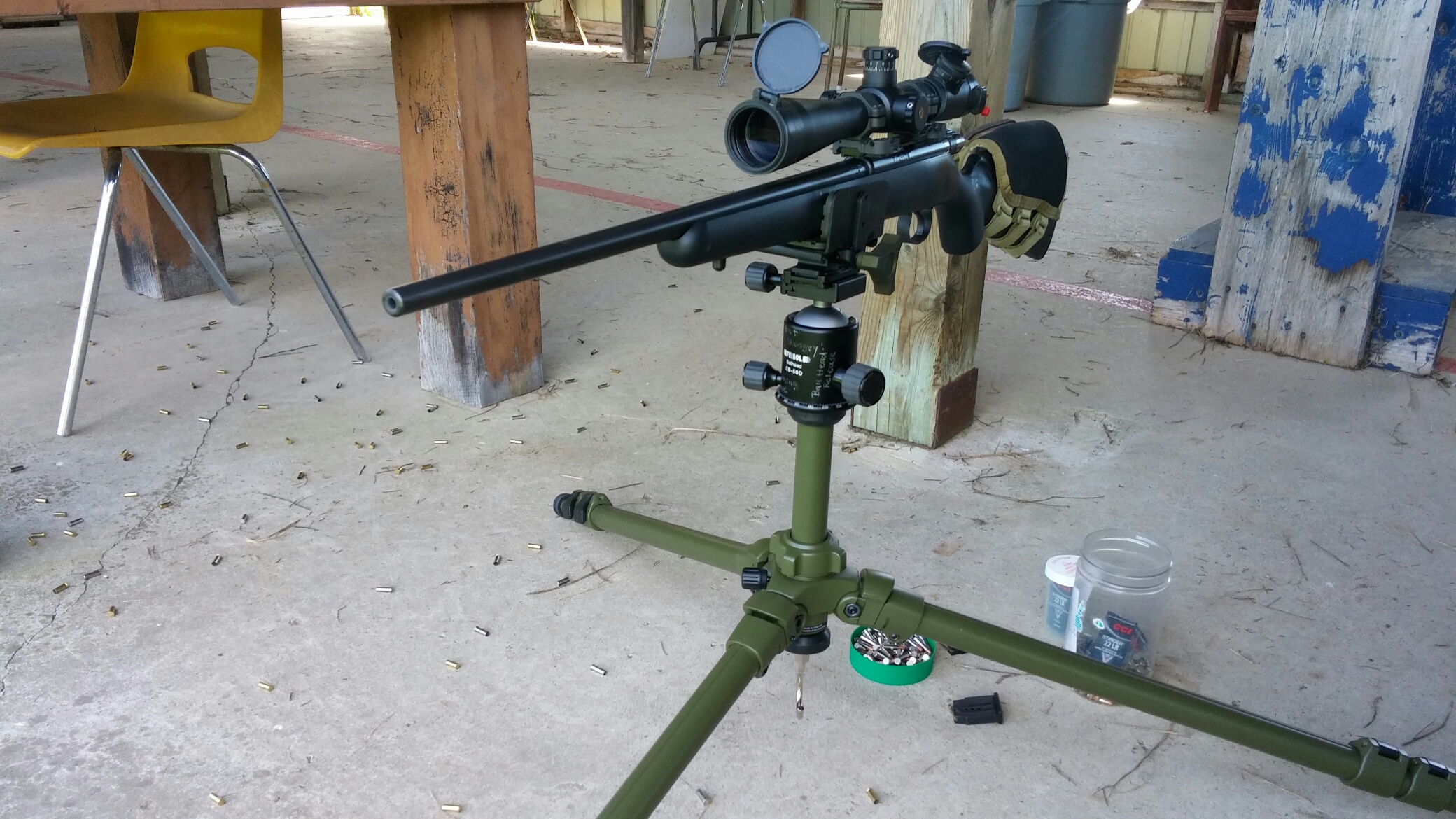

I bought one and here it’s set up with my training .22 LR..... you guys DO train don’t ya?

I also purchased the Feisol ball head assembly from the USA because the shop recommended it’s higher strength rating (heavier than any DSLR). It works well with the PIG0311 tripod. I used this tripod at the Meaford LRSC this past 2017 Labour Day weekend with my Kowa TSN82SV on top. Most impressed. So now I need a second PIG 0311 for my spotter Bushy Legend Tactical Mrad...
I shopped around for a second tripod just for spotting purposes but a SLIK 700 with a pan head was gonna run me just around $200 anyways.... besides Bartok5 knows the number 031 and we just cannot resist
