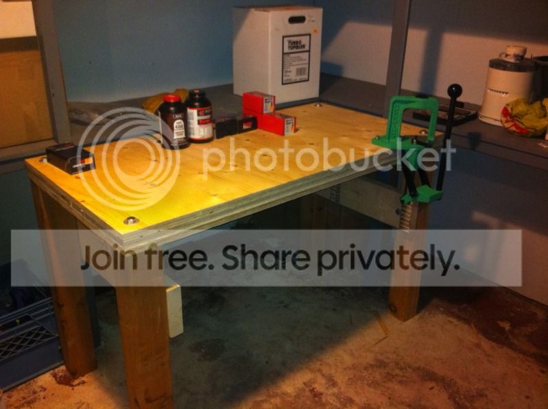

I wanted to just purchase a work bench at Lowes but my wife insisted that we put one together. She's the handy one around our place. I got the basic idea from Peet Peens; whose reloading course I took, as he has a longer bench like this one.
Goal was to build something that isn't fancy but can serve the main purpose of sturdy support for one (or more) press(es). It is 4 ft long x 2 feet wide. Top is 3 pieces of 3/4 plywood that are glued and screwed together to become a 2.25 " bench top. 4x4s on the corners that are bolted to the top with 1/2" x 8" bolts. Two 2x6 supports - although I doubt they are necessary. Feel pretty good about it.
Bolted my Redding Big Boss II press and I'm showing off some of the components I plan to start with. Still waiting patiently for an order from Natchez to show up with my Charge Master, dies and few other items (been three weeks now!).
