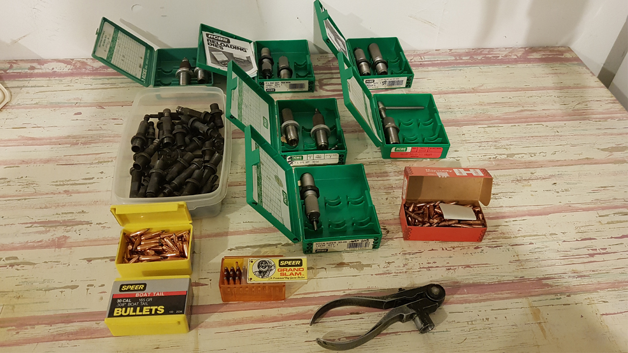

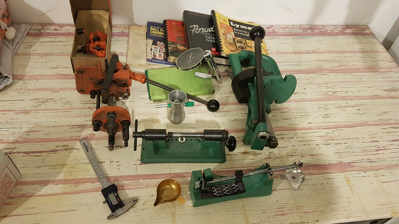

I doubt I can answer everything - but the orange turret press and the "pliers thing" look like they use the dark dies in that plastic box - likely work fine, if you can figure them out - they are older Lyman things, I believe - not sure if in production any longer. The green stuff, generally, is great stuff - looks like a lot of RCBS tooling - can not go far wrong with that - something to trim to length, to weigh powder, a selection of bullets, primers and powder, a selection of modern 7/8x14 tpi body dies - all should fit well in that green Rockchucker press which was a go to for last 30 or more years - that powder is older era packaging but might be still fine to use - depends how it has been stored. I think you have a great start for tooling. As per your second post - pick up the latest Speer manual - about first 1/3 or 1/2 will give you step by step how to use most of those green tools - will not be far off base to just read it, and do what they say. Those RCBS dies should have come with RCBS Instruction sheets - pretty sure they are available on-line - again - for a start - read and follow how to set up and use. Make rounds that go "bang". Down the road you can "fine tune" and get into fancy stuff - but for now, at the start - just follow instruction - make some ammo, and shoot it. Even at most basic, you will make at least as good as common commercial ammo, for much, much less per round, but you will not save money - you will shoot more!!! Just have to come up with cases to load...

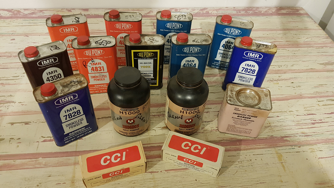

The only thing I would caution you about is the powder. Judging by the prices on the cans, it has been around for a long time and if stored improperly, might not have the same burn properties it once did. Powders can be slightly different lot to lot and certainly over time manufacturers will change the characteristics of the powder slightly as well to the point that the latest load data might not be correct. The powder could be degraded and at the best not give you the advertised performance, at the worst... be dangerous.
The pliers are an Ideal/Lyman 310 tong tool. A great "old time" hand press that use the black dies in the tupperware box. Even though it is old, it can be handy to use if you are at the range and you want to do some load development. There are plenty of videos on youtube on how to use it.

Most experienced reloaders either swear at Lee dies or swear by them.
I generally swear at them - except for their universal depriming die, their universal case expander die, and their awesome collet die for the .303 British - especially if you're reloading that cartridge for a Lee Enfield. If you want to get best performance and case life for Lee Enfield's you need to adopt some other than the usual reloading techniques. Lee Enfield's don't have "excessive head space" - they have chambers intended to reliably chamber every round, no matter how dirty, how covered with corrosion. Change die setup to deal with that, long case life, happy wife (because you won't be pissing money away buying new cases all the time).
Looking into the future, look for some outlet selling PPU .303 British brass. Prvi Partizan new unfired brass for reloading is a bit spendy, but it is light years ahead of Remington, Winchester, Starline, etc for reloading. It has case rim dimensions and other that is much closer to military ammunition cases than other manufacturers. Case dimensions of my new PPU are nearly identical to my 1968 Greek HXP ball ammo that DCRA competitors prized.

BTW, I will take those old style powder cans when you've emptied them, unless you have a use for them other than as garbage. My powder magazine was built to dimensions that fit four rows of those powder cans - the new round powder cans screw up my powder storage container layout. I have some hunting and flyfishing friends in Sperm-wood (and Hooterville up the road), so I'm up there fairly often. If you're troubled by old powder, I will sacrifice myself by offering to take on the burden of disposing of it for you.
From the prices on those powder cans, they look to be about circa 1980'ish. Could have been from Guncraft in Calgary, or Art Green at Norbury Lake Sports, depending on which way the original owner went after turning on to the highway at Sparwood to buy his reloading supplies.

Inertia, hammer type bullet pullers are (in my opinion) better than collet type bullet pullers. I have a Bonanza collet bullet puller and an RCBS collet bullet puller. I should sell them - they have been gathering dust on my reloading bench since I bought my first $8 inertia bullet puller. Collets for a given caliber cost more than that.
Everything I reload that doesn't go through my Dillon or Ponsness Warren progressive reloading presses gets hand primed these days on a hand primmer like the Lee in your picture.
That RCBS case trimmer you have there is as good as any other collet case trimmer out there. My Forster is pretty much the clone parent of that RCBS. it's been reliably trimming rifle cases for about 45 years.
You have the ubiquitous powder trickler there. I have one just like it. But back about the mid 60's, reloading with my Dad, I got in the habit of trickling the last few grains from a long handled spoon appropriated from a soda fountain joint, dipping the last few grains of powder out of a porcelain glazed metal bowl Dad stole from Mom's kitchen. I'll never change now, but those powder tricklers work fine.
That looks like a lube pad. Spray on lanolin/alcohol case lube works just as good with less mess for about 99% of resizing jobs. For the remainder, Imperial case sizing wax is excellent for resizing jobs when you have to really lean into the machine operating lever. Stuck cases suck, BTW, inevitably it will happen to you. Have a plan... I've never stuck a case using Imperial Sizing Wax.
Lyman's VLD internal deburring tool is as good as any other VLD style neck internal deburring tool. For the outside deburring, they're all pretty much the same thing.
I will say that after 50 years of reloading, there are very few cool gadgets and gizmos on my reloading bench. I do have a lab alcohol lamp on my bench that most won't have - annealing brass both contributes to accuracy and enhances case life, particularly for stuff like .303 British brass. But most gadgets they try to sell you, you probably don't need.

BTW, I will take those old style powder cans when you've emptied them, unless you have a use for them other than as garbage..... If you're troubled by old powder, I will sacrifice myself by offering to take on the burden of disposing of it for you.
The empty containers can be all yours. I'll keep your PM you sent so I have your contact info
Original owner is in Kamloops, so could be anywhere
I'll add it to my shopping list
I'll need to get some shell holders for it since I am fairly certain it uses different ones to the press
