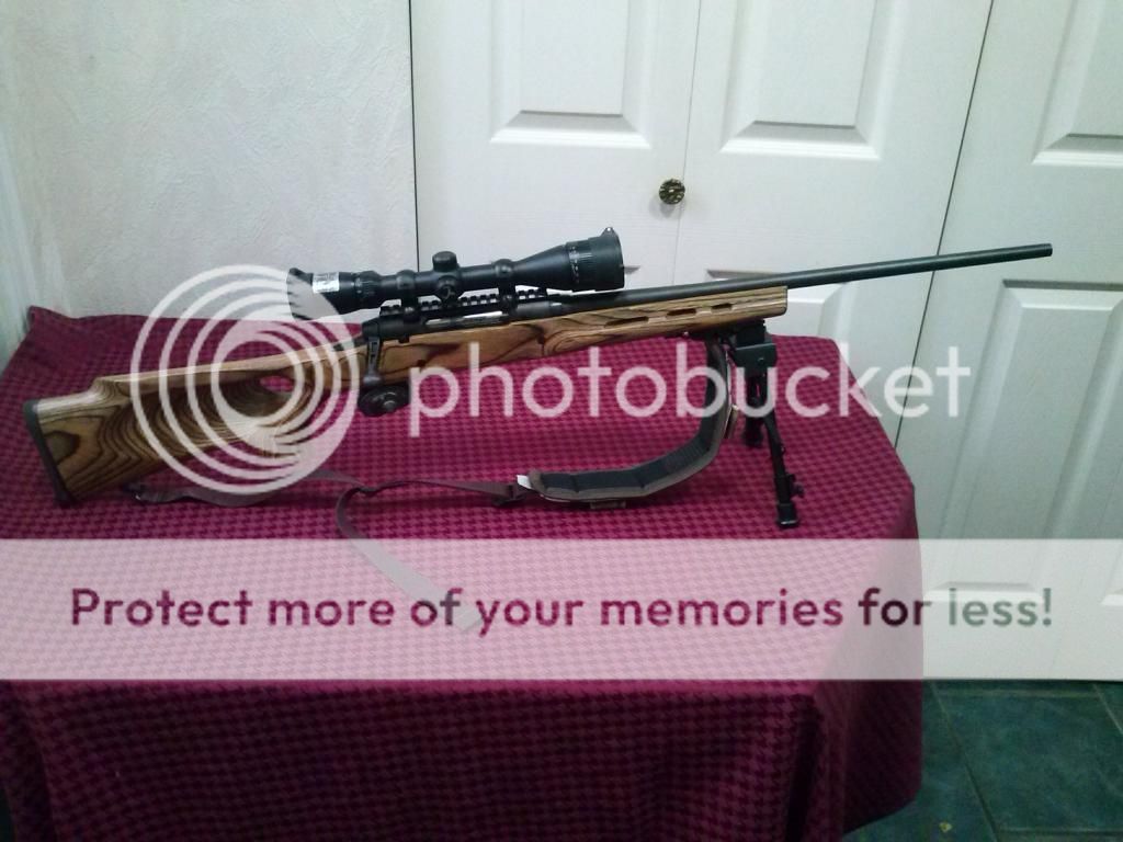

As I stated, I didn't pick the 7mm-08 because Lee doesn't make a lee loader for it. They do however make one for the 270. Once i get two or three boxes of ammo down the pipe I'll grab a lee loader and reload. That is largely why I ask about bullet choices.
I'm thinking i want to try and work up two loads - something cheap in 130 grain like winchester bullets, and then something better like maybe a 150 partition. If I'm not mistaken, the ballistics are very similar out to 400 yards if zero'd at 200, due to the lighter faster load having a worse ballistic coefficient.
Congratulations on your choice of a .270. Its a fine general purpose cartridge, that can be a real giant killer if the hunter does his part, but more important is its versatility. Rifles chambered for the .270 tend to shoot well, and handloading for the cartridge is a straight forward process. You've made a good choice.
