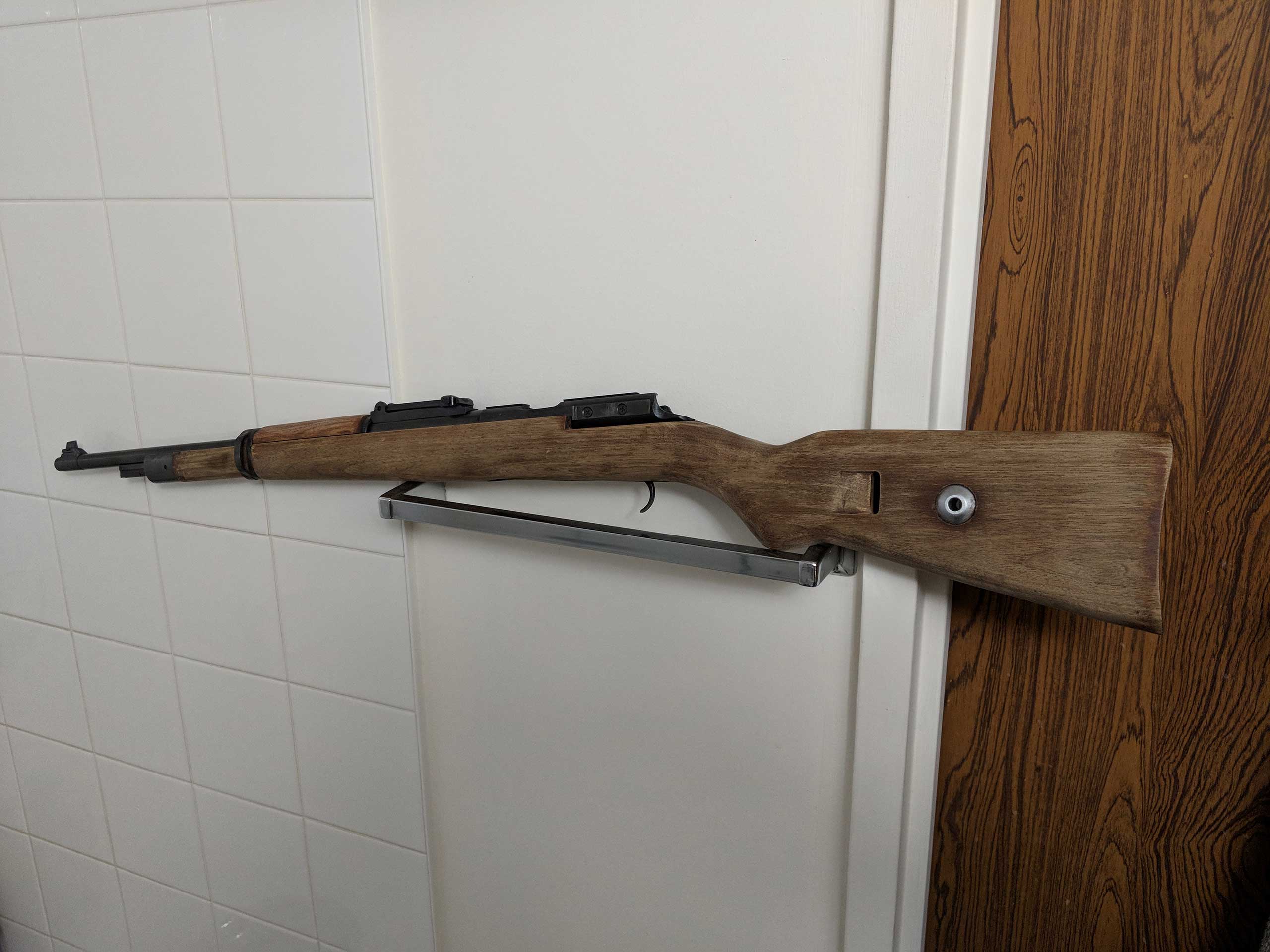

Got mine on the same $99 sale a bunch of you folks got yours from probably ten years ago now. It shoots pretty well, but I couldn't stand how hideous it looked and felt. I always said I was gonna get around to refinishing it, and years later I've finally started. Looks way better than before even without any finish after stripping the old gunk off. I'll give it a week to dry then I'm gonna start with the BLO treatment.

Can’t wait to see it refinished coxswain!

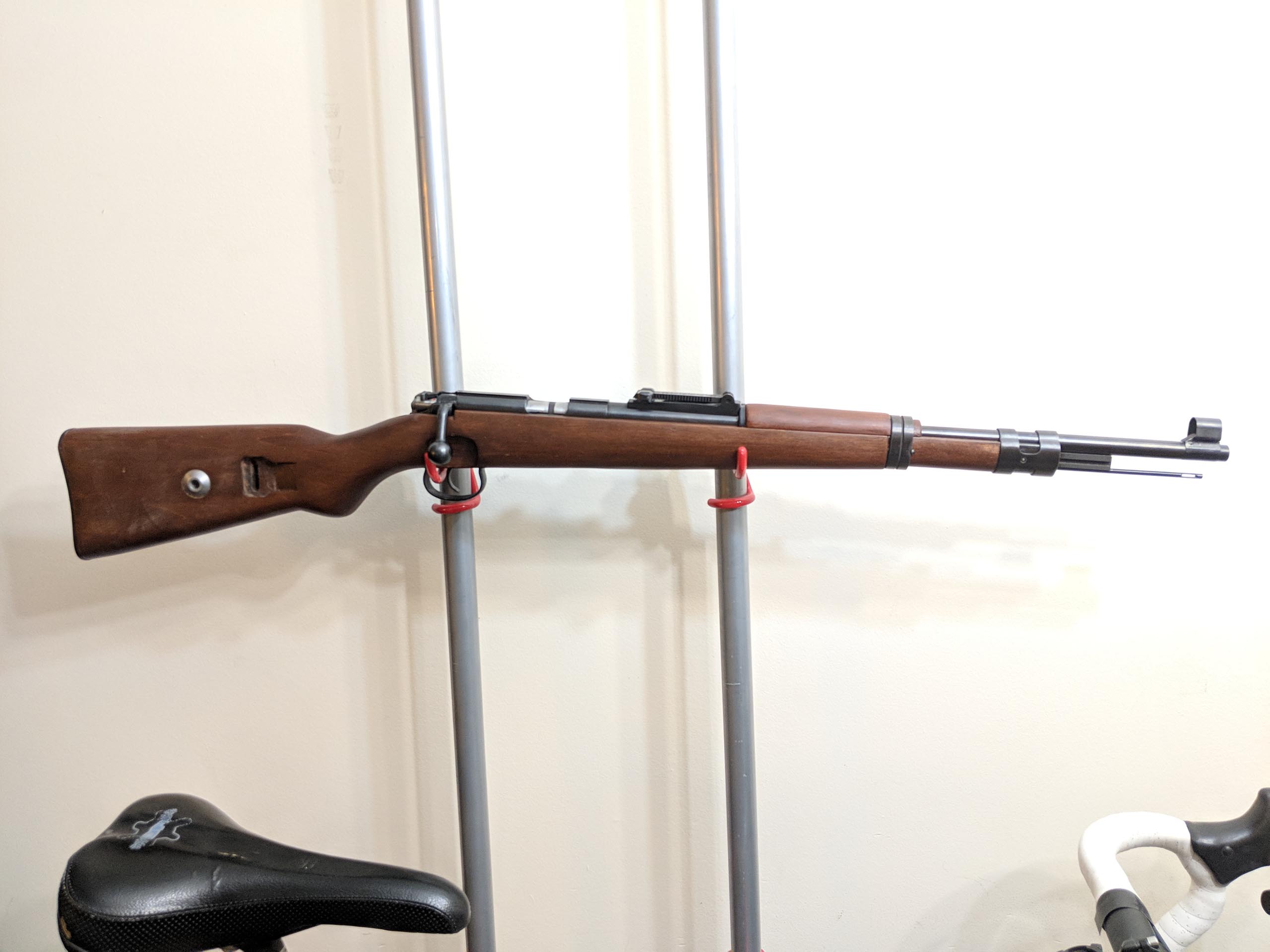

While on the topic of K98 wanna be's, you guys need to add one of these to your K98 collections to be complete! For those who aren't familiar with it, it's made by Diana. I was going to buy a JW 25A when they were on sale a couple of years ago but for some reason I didn't buy one at the time.
Diana K98 will be around 600$ after taxes,shipping and all.Thanks but I'll take JW25A.Then again ammo for it is way cheaper than 22LR...
