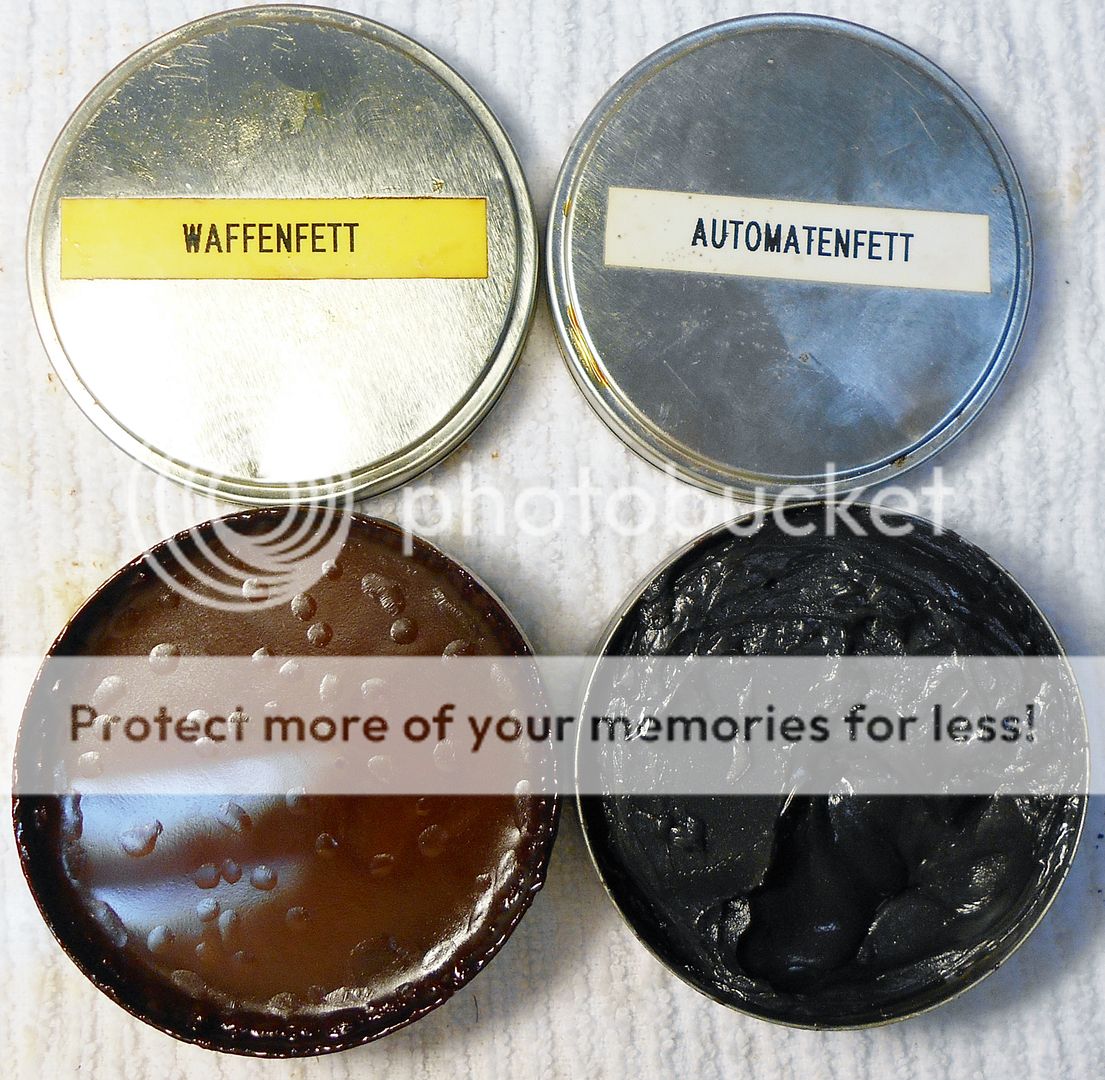

When I opened up the rifle, I got the impression the barrel had a heavy coat of wax on it. Is that a standard treatment? No sign of rust.
Only among some serious Swiss target shooters who know about it. It is not against current or past Swiss Military shoot regulations and specifications.
What is on yours might be the previous vegetable based, amber colored grease(Waffenfett), literally weapons grease) used before the current Automatenfett (automatic weapons grease.).
May have applied just as a rust prevention measure. Might have been it's use that made target shooters realize it's benefit for sticky barrel channels.
Clear(ish) wax would be less messy.
Bees Wax, Floor wax paste, even bullet lube.
Waffenfett is amber in color when new and thinly applied.
Guisan was selling the two version of Swiss grease in these tins that look like shoe polish tins for ease of mailing the products.
Is he (she) still selling Waffenfett?
He died April 2015.
I'll see if his wife still has some, doubtful. Like finding virgin unicorns last 5 years.
I Emailed her, will let you know.

Automatenfett is black and gooey, and intended for use on semi-and fully automatic firearms. It can be splatty if you leave it flapping around after too liberal and application. Not that it's no good, it's just that plain ol' waffenfett is just that - a plain mixture of what were then readily available materials, made up into a good all-round grease for inside and out of a service firearm. It is not a magic elixer, and any good modern grease of the same kind will do the same job, equally well. I've been using the same tub of Shakespeare spinning reel grease since the late 1980's, and all three of my Swiss gals are still in great condition.
