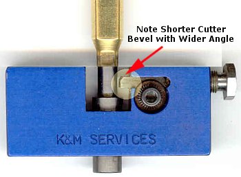

Hey anyone have the K&M neck turner, I just wanted to double check if the I got the cutter in the right orientation. I was able to practice on a few cases I had lying around and it seem to cut but I just want to be sure. Working my way up to turning the expensive Lapua brass.
Also if cutting the shoulder a little bit is the cutting bit suppose to be in a different orientation?
The K&M's website is piss poor with their description and adjustment. 6mmBR site doesn't turn up much either good instruction but no detail about the cutter. Any photos would be apperciated.
