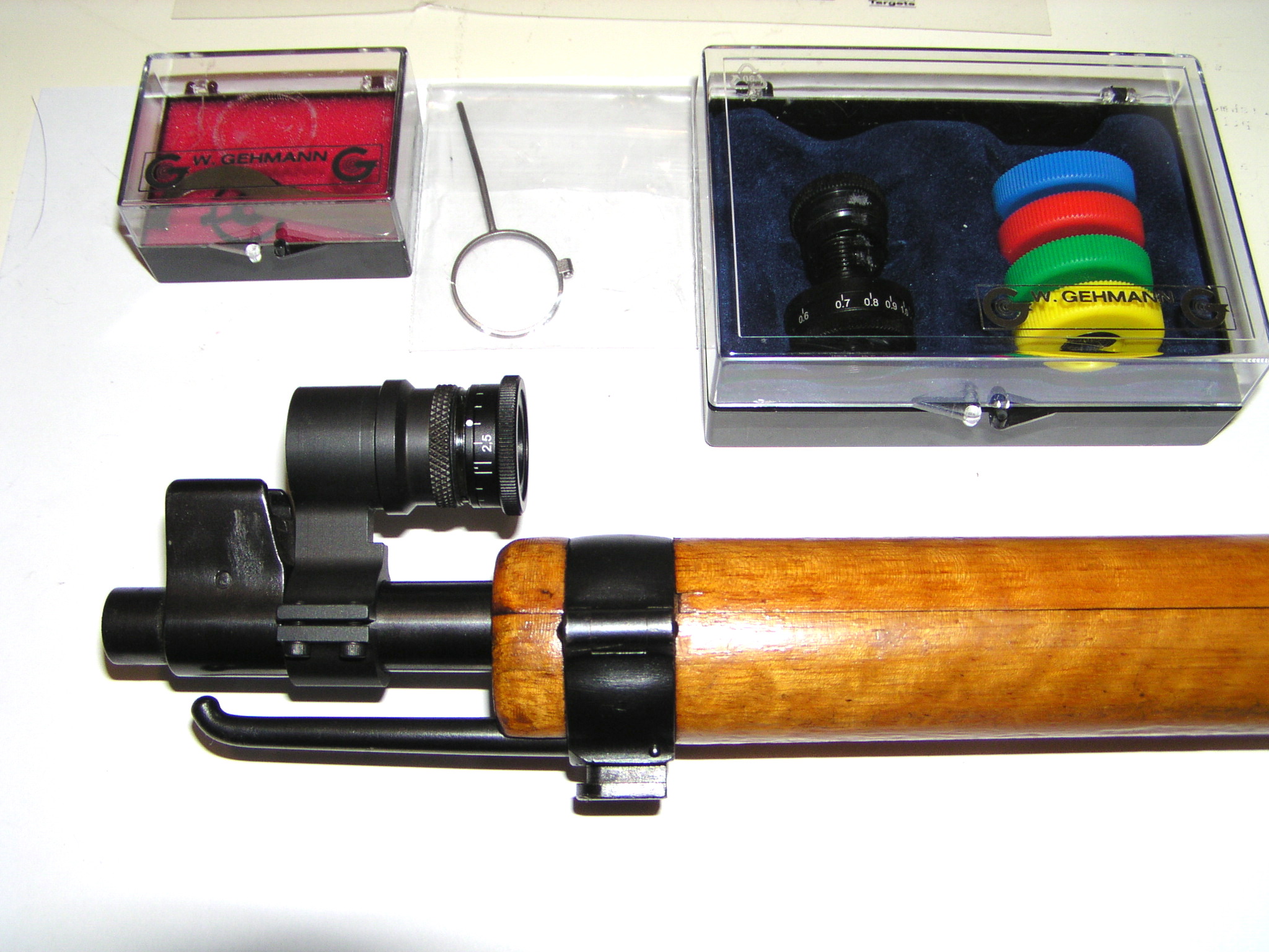

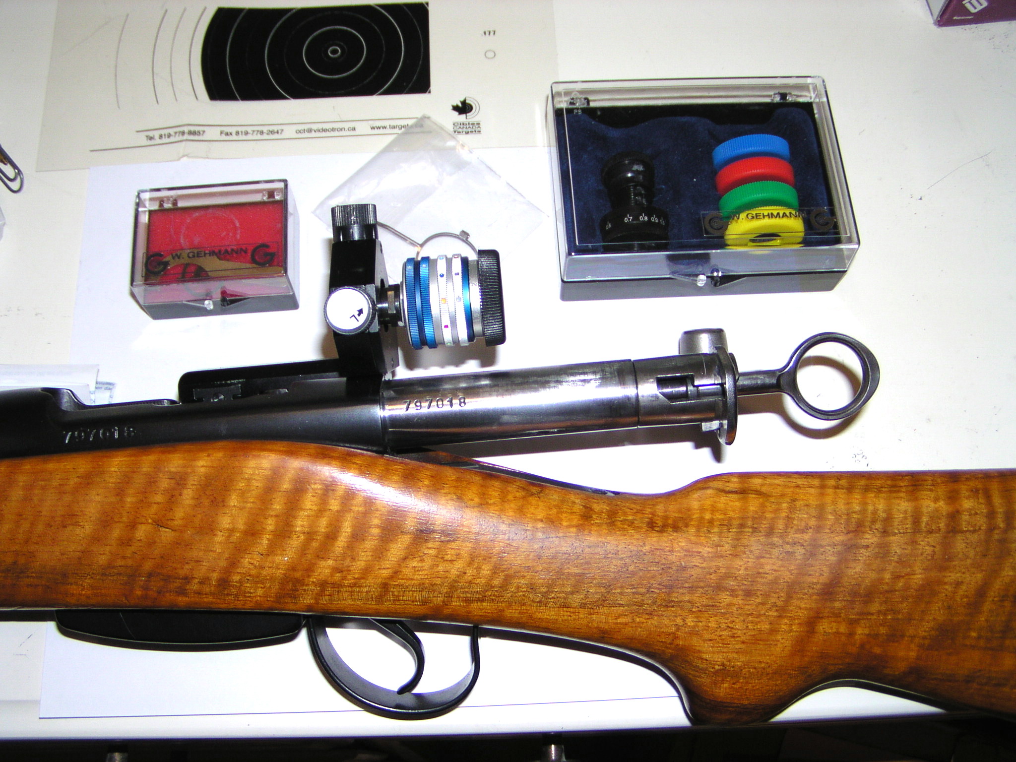

Yes I talk to Pierre (Swiss Products) about that on the first prototypes. I asked/convinced him to bevel the top so the thumb would not meet a 90° edge on the scope mount when using the chargers.
That bevel also makes it easier to insert the chargers into the action with both the diopters and scope mounts
