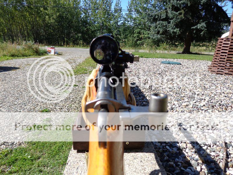

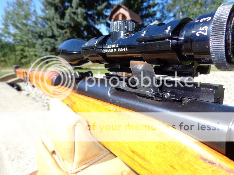

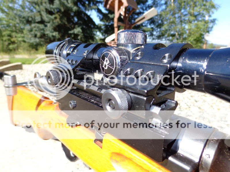

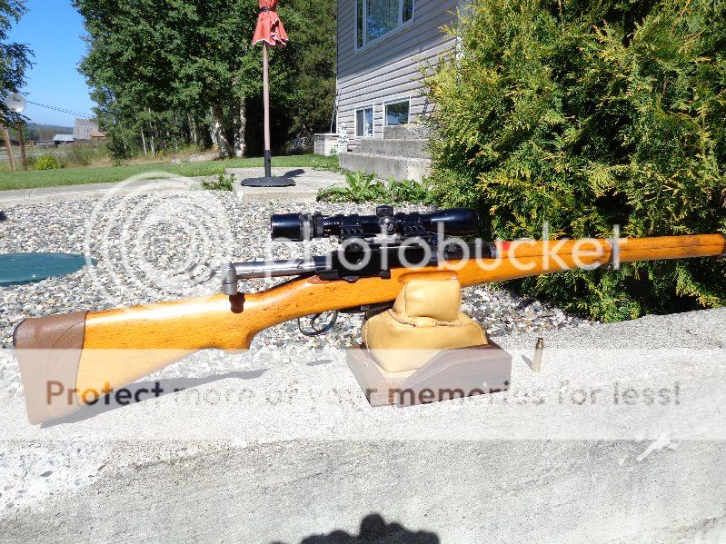

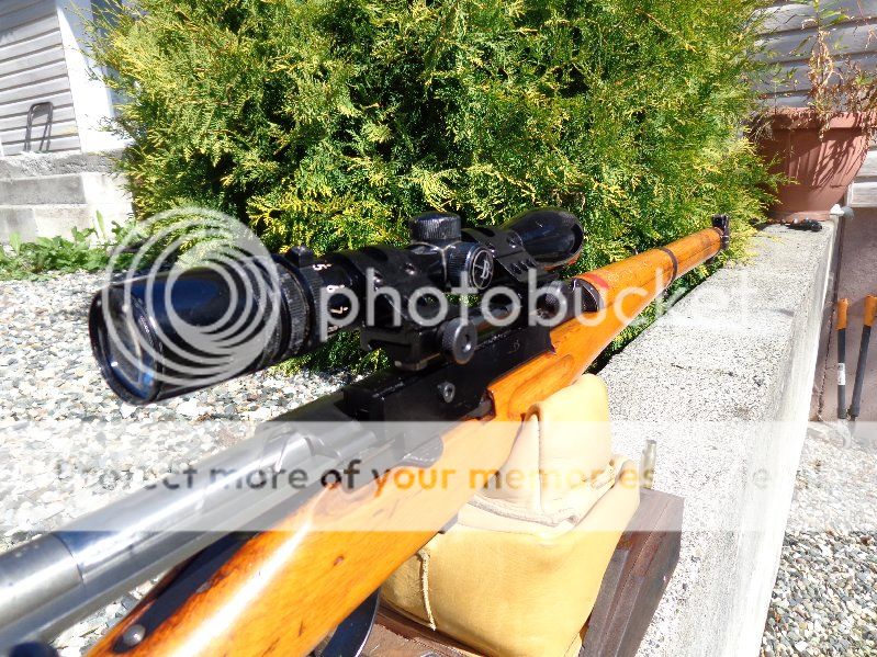

Using the NO drill&tap SWISS mount and off set rings plus a small deflection plate. I have managed to set this up with the scope centered, so the BRASS ejects to the left, the bolt is pulled back with NORMAL effort and it spits them out every time. The deflection plate is stainless 0.015 thickness. Simple and works.
