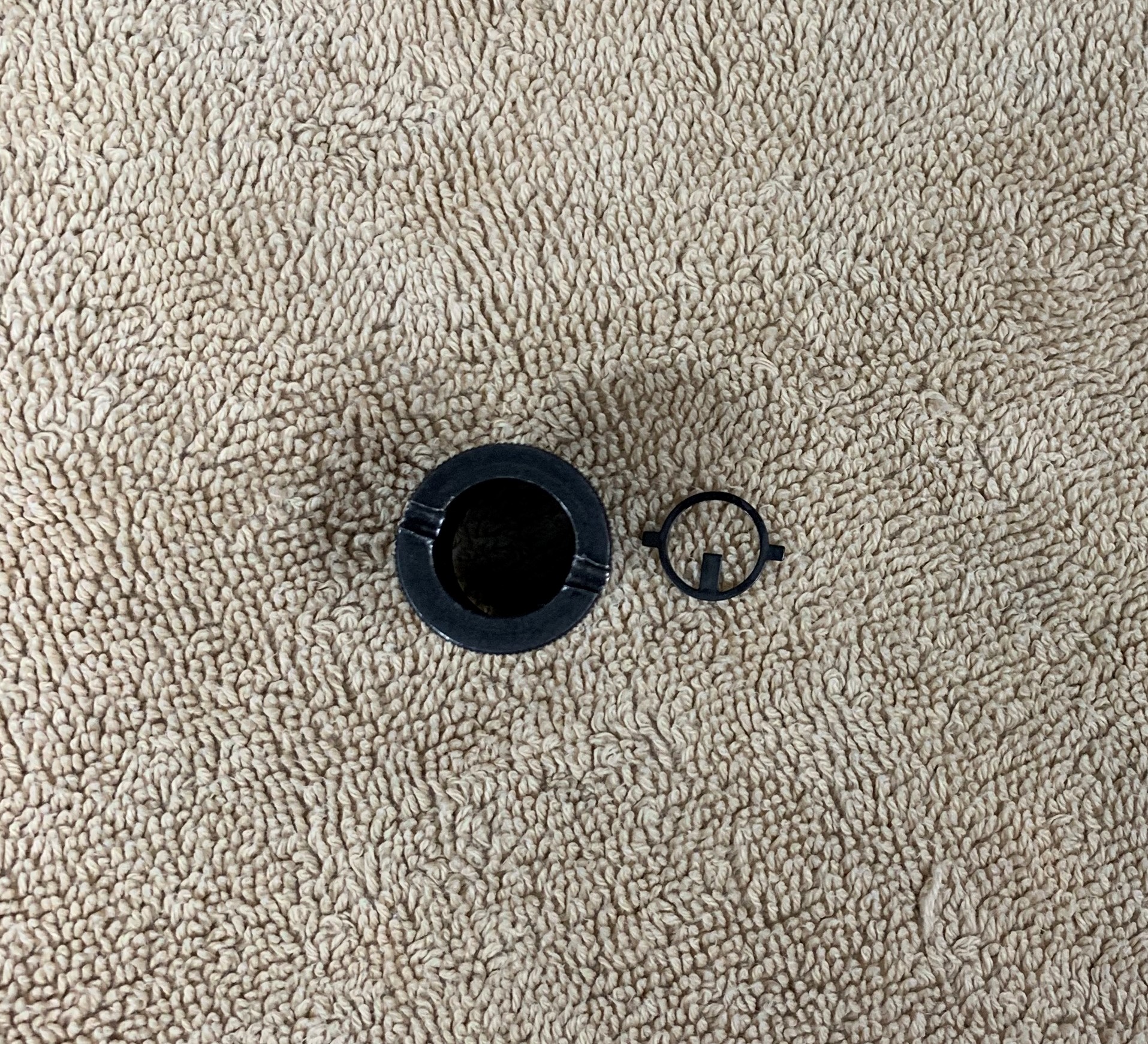

Hi
I have a Diopter on my K31.
My front sight pictured above is the 5 CM tunnel, soldered on replacing the blade sight mounting.
A few Questions:
Q1. Does this type of front sight have a specific name? (it is different then the more common ones I see with Diopters).
I find the front post a bit thick.
Q2. Does it use inserts and if so what are the specs of the replacements and where can I acquire a set?
Q3. The rear appears to be removable(to add an insert) however, mine is very tight and will not budge by hand.
It their a method to remove (a quarter may fit in the slots) and I assume it is righty-tighty and lefty-loosey?
Thanks!
Oil the slot where the threads show through and around the knurled round nut and leave overnight. Repeat for a few days before attempting to turn.
Try a rubber strap wrench before marring up the nut.
Those were made by Hämmerli. Believe they are an M16 insert diameter size (15.1mm)
Vostok CM2 (early) & Ural (early), Parker Hale FS22 / PH1 O.D. .594" 15.1mm
Measure the diameter when you can take it off.
Try contacting Paul Reibin, Range Sports In Kamloops, B.C. for usable inserts.

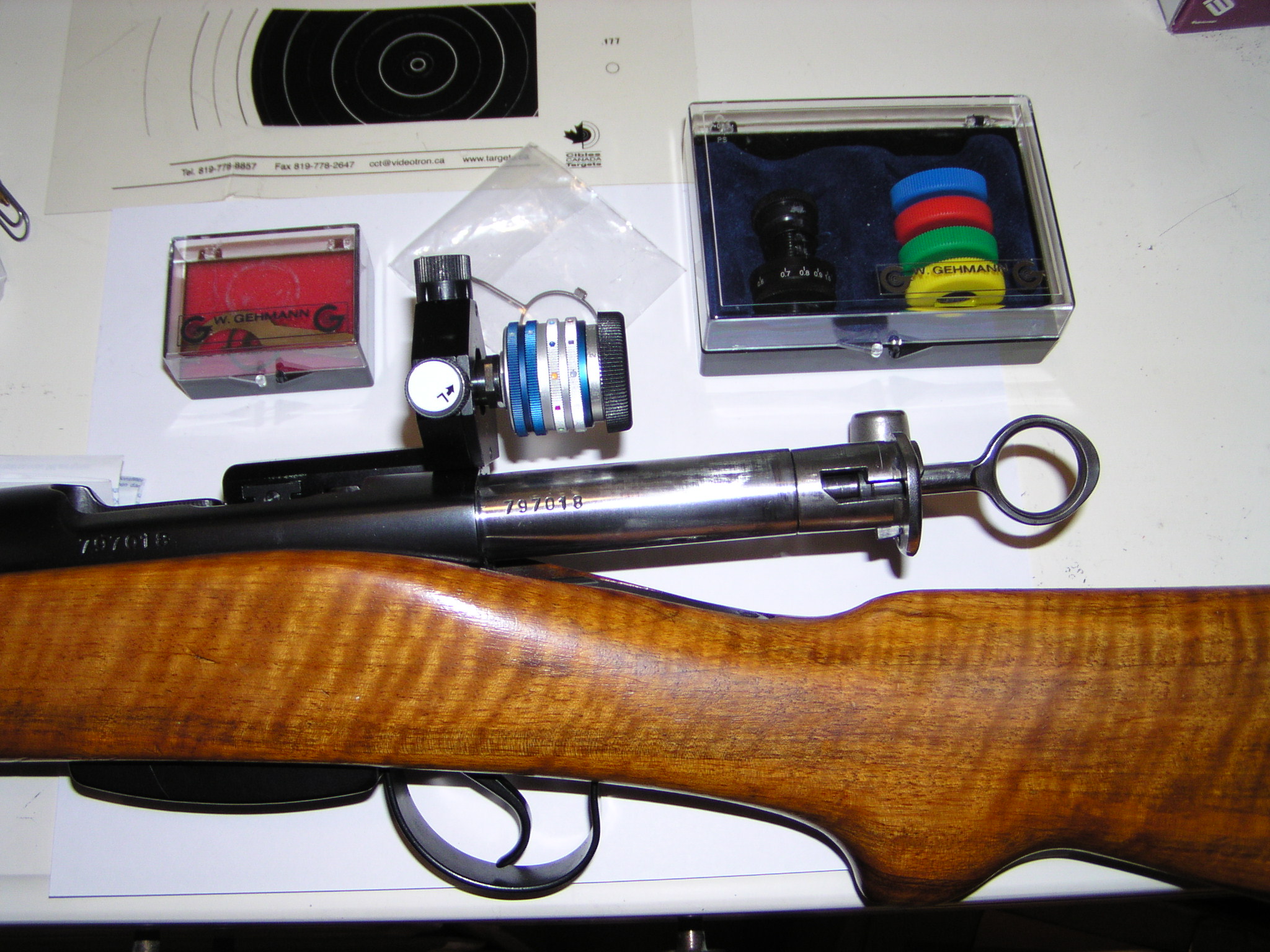

The U.S. made Swiss Products diopters correct in the direction you want the shot to go. they have only an arrow on each knob.

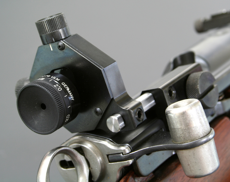

Older version of Swiss Products Diopter sight
Newest version:
Click adjustment values are the same as all the Swiss W&F, Hämmerli and Wyss made diopters

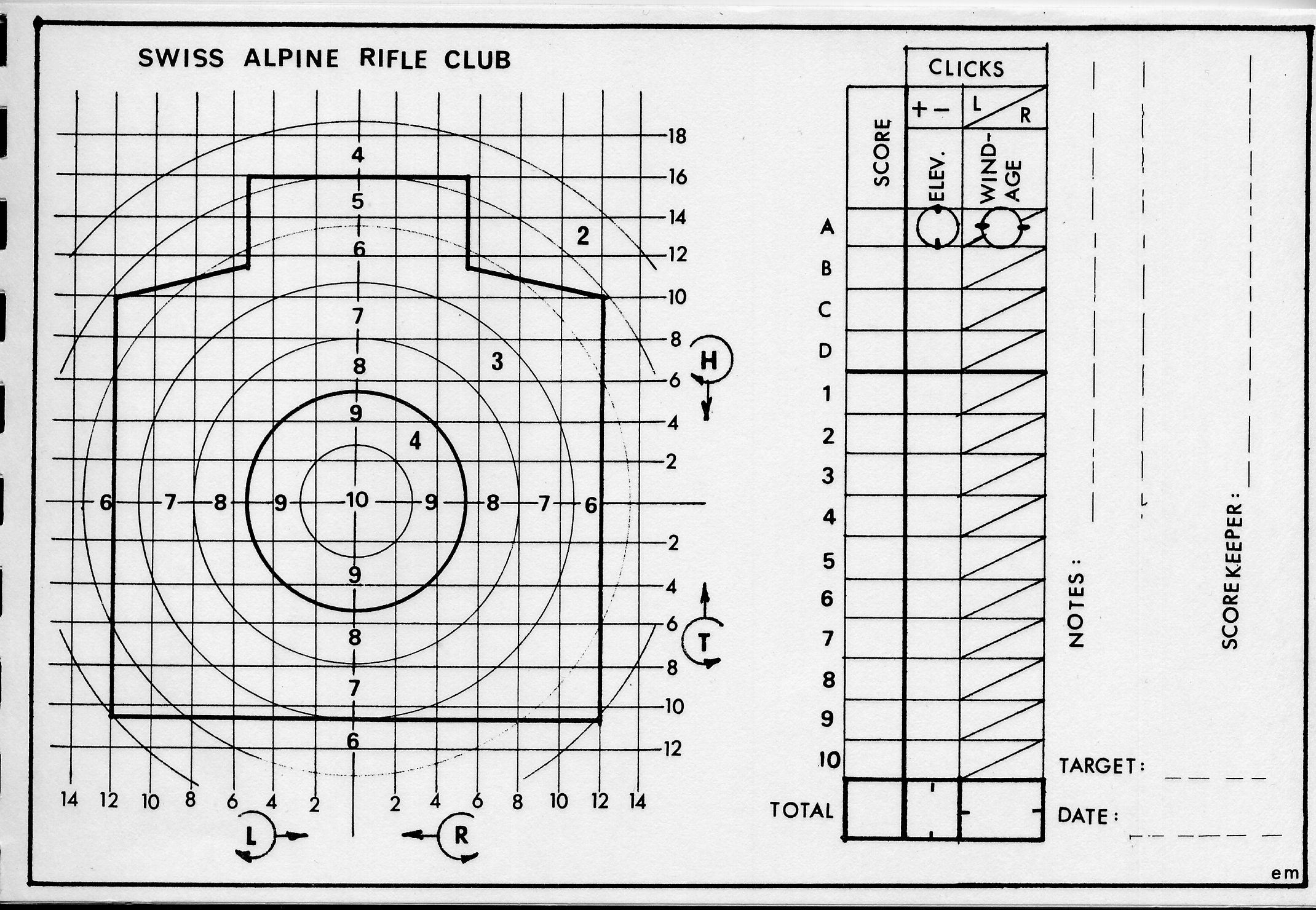

Sight corrections log sheet for 300m Swiss A10, round black, and camouflaged military silhouette Swiss B4 targets.
Numbers on grid bottom and right side are number of click corrections for impacts.

Sighting in a W&F diopter set:See notes at end for a Swiss Products Diopter
Pre-sight in:
1) Make sure rifle is unloaded.
2) Install diopter set properly on to the rifle. Make sure all the diopter screws are tight.
3) Loosen both action screws and both barrel band screws.
4) Hold rifle vertically with its butt plate against the ground, grab barrel and push towards butt.
5) Tighten front action screw first, then tang screw. Some rifles are better if you back off tang screw slightly.
6) Tighten front barrel band. Barrel should be centered in stock. Leave slightly loose for most rifles.
7) Tighten sling barrel band only enough so that the spring detente can still be moved when you press on it.
