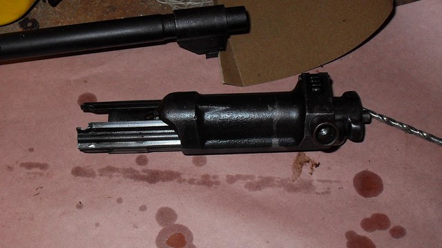

Its got a distinctive stained bolt carrier

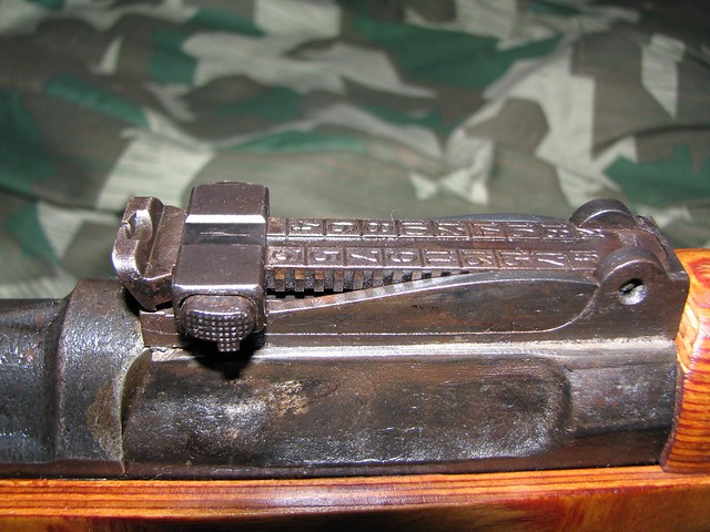

and a odd K98 back sight

It's got a fake stock the seller clams to be original/refinished and the receiver has been bubba'd and a non-correct site base soldered on to deceive - no mention of it by the seller asking big bucks for it...

Im worried at the look of the front of the bolt carrier, it looks like it was ground down some since I owned it.

btt - Compare the Two sets of pics for the rear sight and receiver modification.

In my view, it's only worth the sum of its parts. In theory someone could weld on enough material to reprofile the receiver to original and track down a real rear sight. Get ready for about $1500 to make it right again, assuming you find someone who can anneal, repair and re-harden the receiver.
If it were mine, I would part it out to restore a less-butchered rifle. I would'nt pay more than $300 for the parts I see and that fake stock would warm my livingroom hearth.

Wow, those pictures certainly help.
With the 300m graduation, it does look like a VZ24 sight. Is it possible, given that VZ24 parts were still floating around in 1944-45, that the Germans put on a VZ24 sight ? It looks like you can see the sodering that is holding the sight base down, doesn't look to be a professional job either.
"Stained" bolt carrier ? I am not sure what this means ?

For starters, germany never made stocks from russian birch plywood - they used beech laminate like on a k98k.
And no, germany did not solder on sight bases and use VZ24 sights for these.
It's all fake and the guy who built the rifle is warning us of that fact in the posts above.
