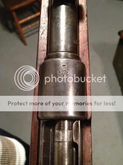

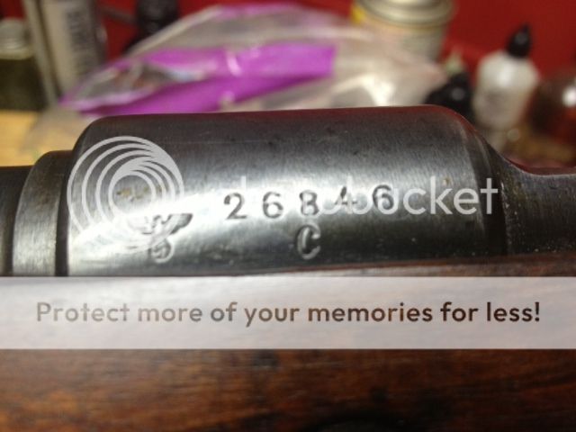

The first (Top) is a 1943 BYF all the waffen marks intact, all parts present and all matching except stock band. If anyone has a stock band on your RC that might have '46' on it... I would love to work something out! Solid walnut stock. The bore is VG+

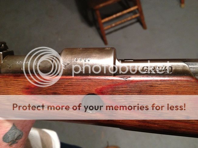

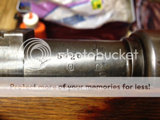

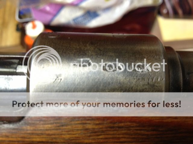

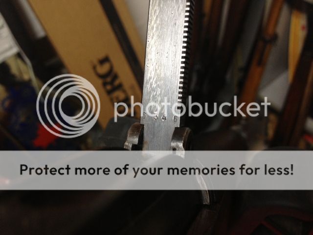

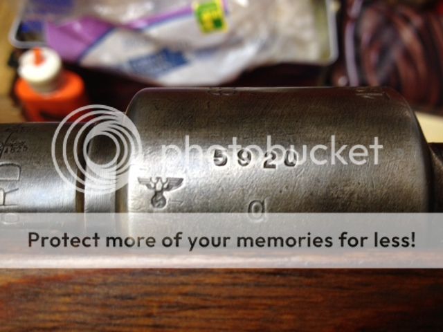

The second is one for the Mauser-Guru's and a little more interesting... G29/40 (Radom/Steyr), 1940 all waffen marks, all parts and all matching (again) except for the stock band. Laminate stock and bore VG.
1) How rare are these rifles? What would this one be worth?

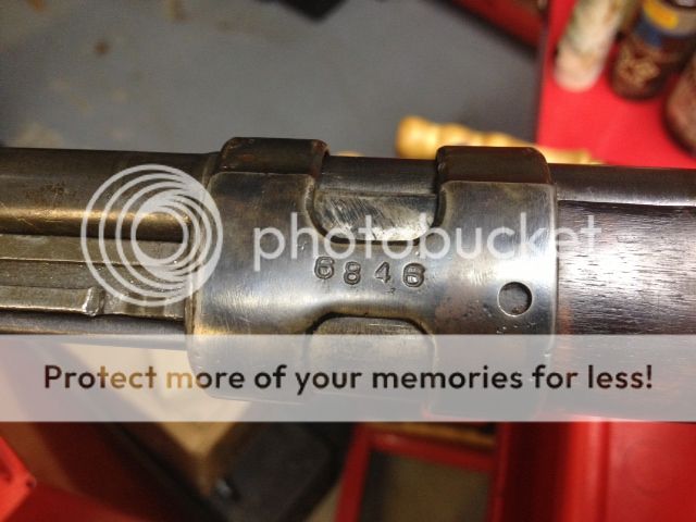

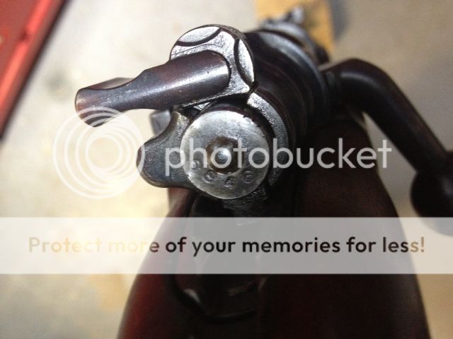

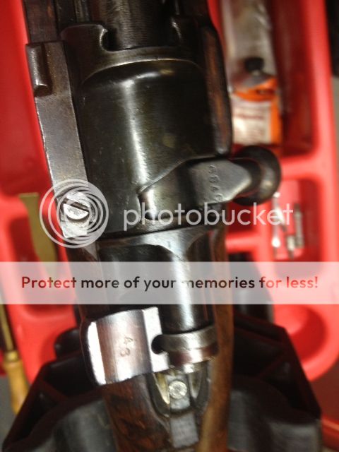

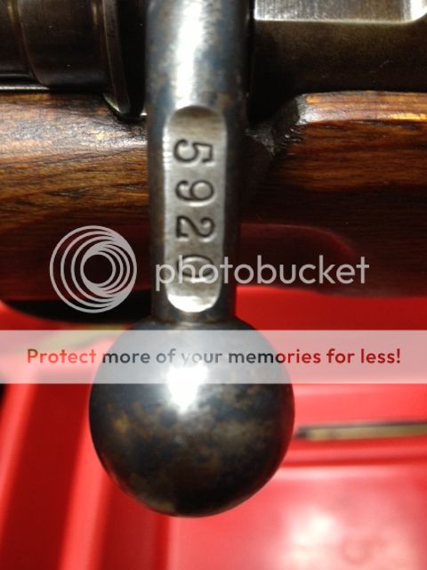

2) The bolt handle looks like it was ground and re-numbered, (if so) the font does look old and the stamping/machining was done awhile ago judging by the patina.
3) Would this rifle have been restocked, as I thought the laminates were used later in the war?... Possibly an arsenal repair along with the bolt renumber, by chance?

As requested: WAAAAY more pics!... '43 BYF first. Thanks for all the information!

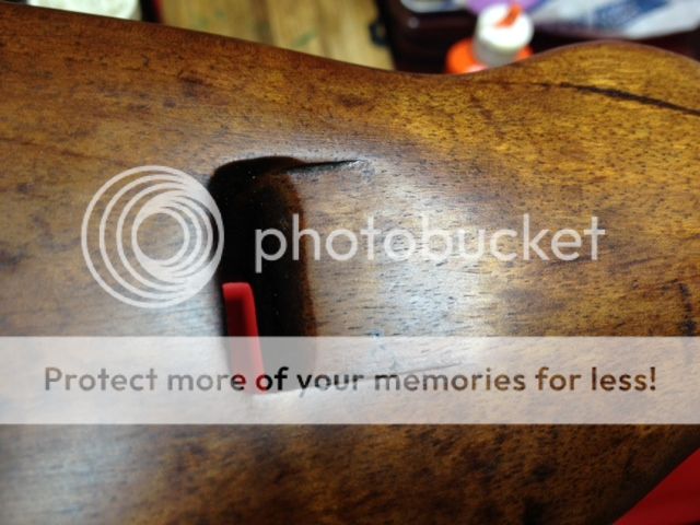

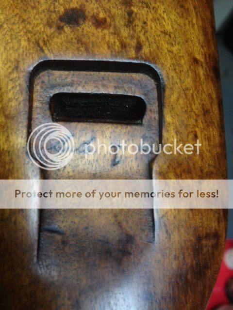

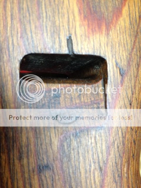

More of the 660 (G.29/40) I looked for any kind of marks on the stock but just couldn't find any, other than two faded (sanded) ones around the sling cut out.
I can tell you that the G29/40 has been through a post war refurb with the bolt numbered like that. I can't remember who did the numbering like that though.
Both stocks look sanded possibly.

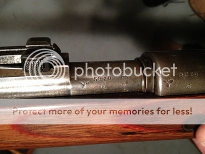

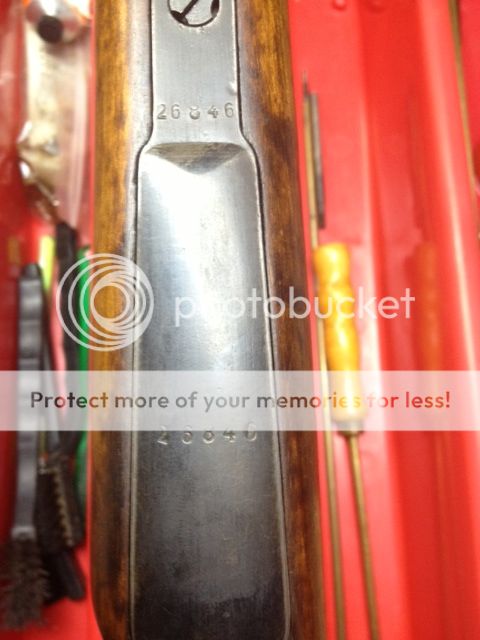

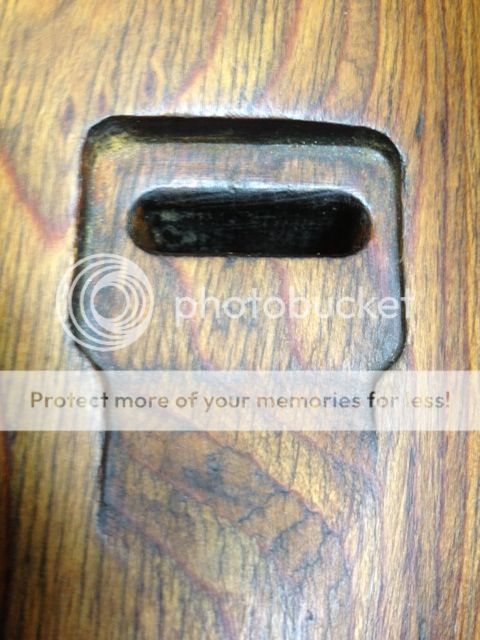

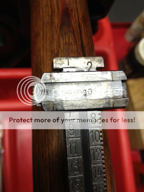

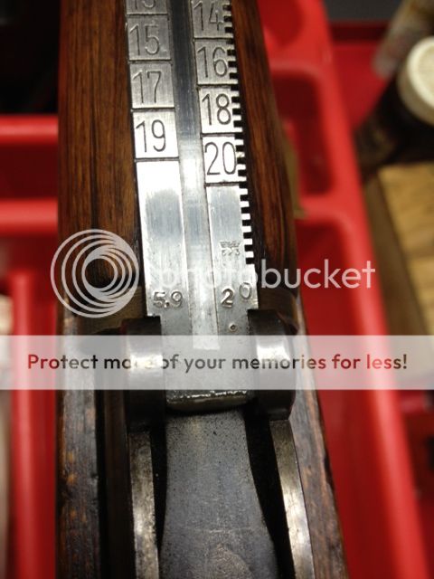

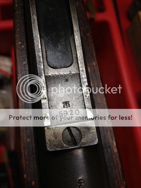

You need to post WAAAY more pics to get an accurate assessment of them. Close and clear pics of ALL the serial numbers, bolt cutout, sling cutouts, and other details.
Agreed. They have been sanded.
The 29/40 bolt is not german numbering .
I also forgot who did it. Romanian /Albanian?

The 29/40 is rare but the condition hurts it huge. Laminates were used from about 37 on.
I think you're right. It was either Romania or Albania that numbered the bolts like that. I'm leaning towards Albanian. Something seems to ring a bell with that.

Just looking at the pics again and noticed the obvious. The byf 43 has a flat buttplate and e/H marked stock on it which is not correct for a byf 43. I'm pretty sure it's a MO stock but just off something earlier. Most likely a byf 41.

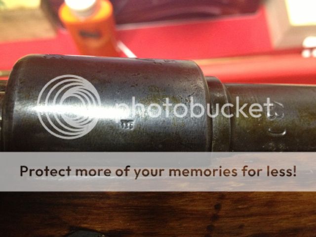

The G29/40 has the export stamp "GERMANY" on the barrel from the 1950's. (In the pic with the 660 1940 on the receiver).
the 29/40 is a German refurb for post war commercial sale . I think these were imported by Globe co. or International.
So that style of bolt renumbering is post war German refurb? It would make sense since it has the "Germany" stamp on the barrel.
I've seen several K98k's renumbered like that but can't remember ever seeing any definite proof of who did it. I was thinking Albanian as I'm pretty sure I've seen a K98k advertised as an Albanian rework with that style of bolt numbering.
I don't think the Germans did the bolt renumbering like that, it may have been done by importer or whoever?? the bolt handles on the ones I have, with the Germany stamp. are not done that way ,but mine came from Globco in the 1960's. they may have done it differently on different batches or for other importers.

We would have to see pics of the serials and waffenamts on the stocks to determine exactly what they are off of. It might be hard though because they have both been sanded pretty heavily. I'm pretty certain the flat buttplate walnut stock is off a Mauser Oberndorf rifle though. Just not a 43 dated one. The letters in the sling cut out, bolt cut out style, and waffenamts appear MO.

Seems strange that the style of renumbering would have been post-war Romanian or Albanian (Communist countries until early '90s), and then to have the rifle marked 'GERMANY' and put on the Capitalist market during the '50s or '60s at the hieght of the Cold War...?

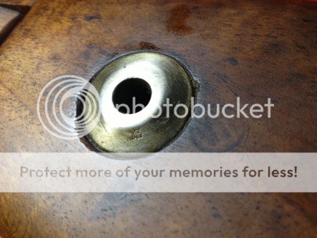

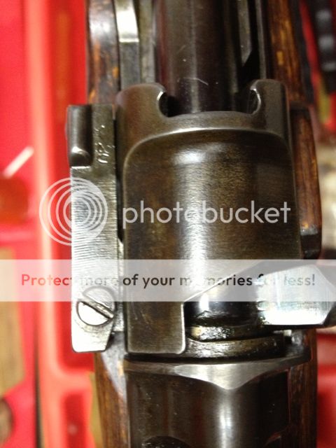

I added more photos of this rifle trying to show any/all markings. There is one taken from the top of the action where you can see some faint marks at the base of the handle where it meets the bolt body. Is this where the original marks should have been?

That byf43 is totally wrong and re numbered. Bolt is bad, band, stock not correct and definitely sanded.
The 660 is ok looking except the bolt. And stock wouldn't be cupped butt.
Are there Any external marks on the stock on the 660??

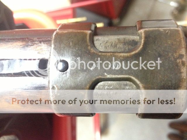

Upper band looks renumbered on the G29/40 as well.
The byf 43, as CanadianAR pointed out, is pretty poorly humped. The bolt numbers (safety, bolt, cocking piece) are pretty poorly done as is the upper band. Lots of issues with this one.
As to the bolt numbering on the G29/40, it could have been done by the importer as gaff suggested. That's a possibility as well.
The "GERMANY" is an export mark, so we know it left Germany and probably on it's way to North America. The VOPO (VOPO-East German Police, reworks/refurbs) K98's and VOPO G/K43's were also being sold in the 1950's and on as mail order purchases in the gun magazines.
