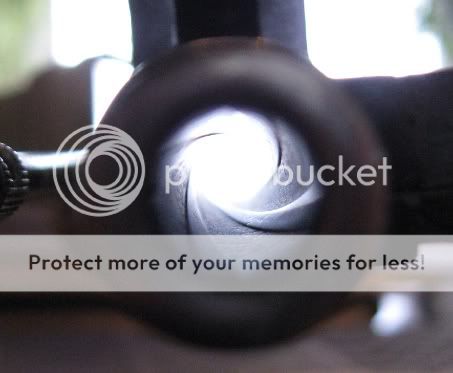

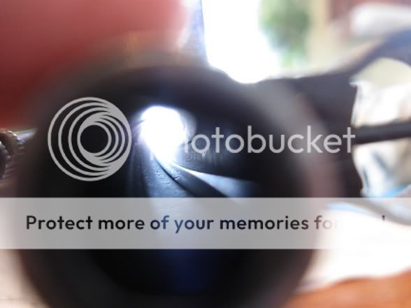

A few pics...
Maybe these will help, the two stock "mounting lugs" and trigger "loop" aren't inline with the barrel
Interesting. Could this be a really poor job of threading? Seems like the threads are not straight on the barrel or the receiver threads are not straight.

I have never seen a barrel off line like that... obviously you should take it to an experienced smith and have him remove the barrel and determine what is wrong... you aren't going to fix this by yourself.
The only guess that I would make is that someone might have tried to remove the barrel without using the proper tools. Put enough torque one the rear section of the receiver and Viola!

It looks to me as if the rails are bent to the left the receiver ring looks straight to the barrel
Run a straight edge along the side of the receiver to the rear of it and measure then check the other side if it is straight then start peeling barrels

I see a definate difference between the two sides of the receiver, one side is bowed in and the other is bowed out. I'm wondering if the receiver could be corrected with heat applied via a torch to both sides of the rails then pryed back.(?)
If heat where applied it would affect the heat treating, and it would require re-hardening and tempering, I don't know of anyone capable or willing to take the risk. Even if this where done I think getting things bent back to their proper positions would be next to impossible. I would have the threads checked as previously stated - hopefully it is just the barrel threads that are out of square.
