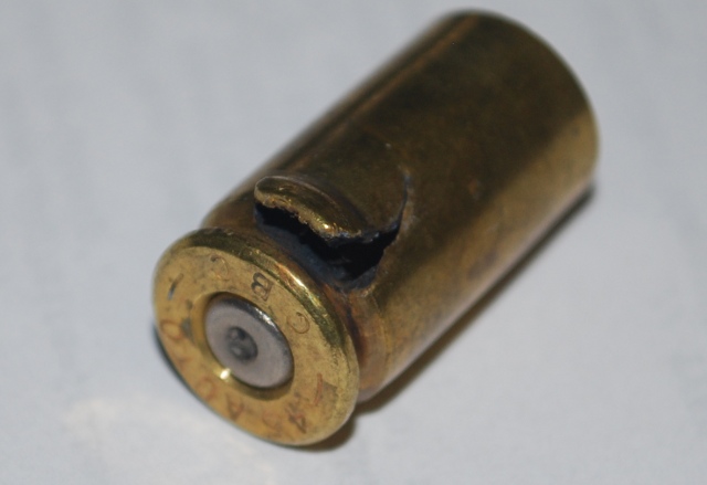

Took it to the range today. Ammo used - my own rolls lead 230 gr, infamous factory reloads. Btw, i've installed 18.5 pound Wolf spring in the middle. Totaly about 100-120 rounds. 50 factory reloads and the rest my rolls.
All went OK. Those factory reloads are VERY HOT. Guy next to me was shooting his Kimber Custom 2 stainless and I've asked him to compare 2 of those rounds with his factory Winchester. They felt significantly hotter to him and much louder. So, I am staying away from now on from this f**ktory reloads ;)
And XO feels much better with this Wolf spring.
Cheers.
P.S. And the picture of troublemaker.

Those are exceptionally high quality macro pics! The first one of the case is literally the best close up I've seen on CGN
Can I assume DSLR and Macro lens?
x3 Bad Case + Hot Load. Simple.
OP, look at the primer. It definitely looks high pressure (see how flat it is.)
I never trust reloads that I haven't done myself. I certainly never push the envelope in brass I don't know the history of.
Here's a bad case; note that the primer isn't flattening (again, the primer on PAGE1 is very flat indicating a "hot load".)
