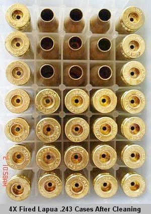

Below photo from Amazon but my cases look the same.
